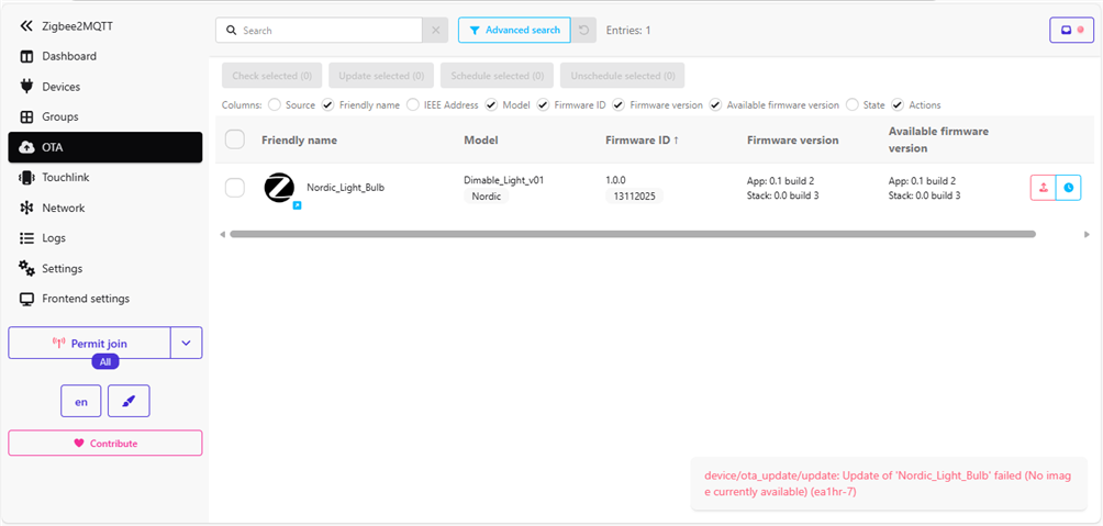

  • Thanks for the information. I can now see the device listed under the OTA tab, but when I try to trigger an update through MQTT Explorer, I get the following error:
    update = {"data":{},"error":"Update of 'Nordic_Light_Bulb' failed (No image currently available)","status":"error"}
    I’ve placed the file 127F-0141-02000000-light_bulb.zigbee in my MQTT local server directory. Do I need to use a .ota file instead, or is the .zigbee format acceptable?
  • The file within .zigbee is ok. But the model ID in zboss must match the model in z2m
    For example: 127F-0141-02000000-Dimable_Light_v01.zigbee

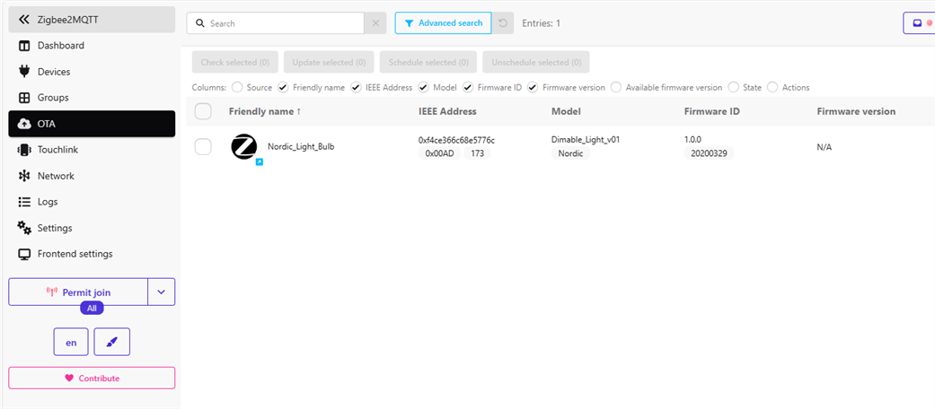

  • When I perform a “Check for update” action, I receive an “OK” response, but the “Firmware Update” button does not appear. Please help me resolve this issue.
