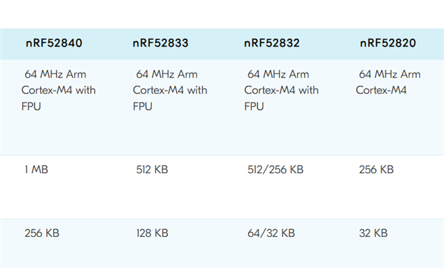

Hi Tony,
The only concern might be memories size since nRF53840 is supported.
docs.nordicsemi.com/.../app_desc.html
You can build the nRF52840 and check if it uses more memories than nRF52832 can afford.
Charlie
