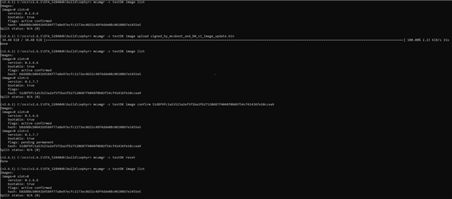

  • I tried to DFU with nRF Connect mobile application, and it's not working as well.
    I've added prints for the mcuboot_secondary partition memory - I had a bad feeling that it writes the new firmware to that partition (although it is not s0 or s1).
    with that print, I can see that it puts data into the mcuboot_secondary partition after the upload via mobile app.
    mcumgr image list:
    first command - after flash and build
    second command - after using nRF Connect application to upload dfu_mcuboot.zip
    mcumgr image list:
    Log file from nRF Connect app:
    nRF Connect, 2024-07-17

    D	16:08:23.554	[McuMgr] characteristic.setWriteType(WRITE COMMAND)
    D	16:08:23.558	[McuMgr] gatt.writeCharacteristic(da2e7828-fbce-4e01-ae9e-261174997c48)
    I	16:08:23.568	[McuMgr] Data written to da2e7828-fbce-4e01-ae9e-261174997c48
    I	16:08:23.593	[McuMgr] Notification received from da2e7828-fbce-4e01-ae9e-261174997c48, value: (0x) 0B-00-00-06-00-3F-23-00-BF-62-72-63-08-FF
    A	16:08:23.640	[McuMgr] Received Header (Version: 1, Op: 3, Flags: 0, Len: 6, Group: 63, Seq: 35, Command: 0) CBOR {"rc":8}
    W	16:08:23.646	[McuMgr] Error: NOT_SUPPORTED (8)
    V	16:08:23.662	[McuMgr] New state: TEST
    A	16:08:23.667	[McuMgr] Sending (58 bytes) Header (Version: 1, Op: 2, Flags: 0, Len: 50, Group: 1, Seq: 36, Command: 0) CBOR {"confirm":false,"hash":"AWxMOBPlaUJJ7uzVaiRd8hPNjSdDFczrTfF+aYJCTlQ="}
    V	16:08:23.671	[McuMgr] Writing characteristic da2e7828-fbce-4e01-ae9e-261174997c48 (WRITE COMMAND)
    D	16:08:23.674	[McuMgr] characteristic.setValue(0x0A00003200012400BF67636F6E6669726DF464686173685820016C4C3813E5694249EEECD56A245DF213CD8D274315CCEB4DF17E6982424E54FF)
    D	16:08:23.676	[McuMgr] characteristic.setWriteType(WRITE COMMAND)
    D	16:08:23.678	[McuMgr] gatt.writeCharacteristic(da2e7828-fbce-4e01-ae9e-261174997c48)
    I	16:08:23.688	[McuMgr] Data written to da2e7828-fbce-4e01-ae9e-261174997c48
    I	16:08:23.726	[McuMgr] Notification received from da2e7828-fbce-4e01-ae9e-261174997c48, value: (0x) 0B-00-00-13-00-01-24-00-BF-63-65-72-72-BF-65-67-72-6F-75-70-01-62-72-63-08-FF-FF
    A	16:08:23.736	[McuMgr] Received Header (Version: 1, Op: 3, Flags: 0, Len: 19, Group: 1, Seq: 36, Command: 0) CBOR {"err":{"group":1,"rc":8}}
    V	16:08:23.750	[McuMgr] Disconnecting...
    D	16:08:23.754	[McuMgr] gatt.disconnect()
    D	16:08:23.778	[McuMgr] [Callback] Connection state changed with status: 0 and new state: 0 (DISCONNECTED)
    I	16:08:23.781	[McuMgr] Disconnected
    D	16:08:23.785	[McuMgr] gatt.close()
    I	16:08:28.838	Connection parameters updated (interval: 40.0ms, latency: 0, timeout: 420ms)
    Please note that I made change to the application too (only changed CONFIG_MCUBOOT_IMGTOOL_SIGN_VERSION="4.0.0+0")
    Please also help me understand why the mcuboot_secondary partition changes when it should be written to s1.

    Second set - using mcumgr from terminal:
    1. Build and flash clean application, saving s0 and s1 as binaries using JLinkExe savebin (e.g. savebin s1.bin 0x16200 49152)
    2. convert them to hex using xxd.
    3. increment CONFIG_FW_INFO_FIRMWARE_VERSION and made minor change in mcuboot main.c
    4. build it, and now using only signed_by_mcuboot_and_b0_s0_image_update.bin
    5. The majority of the following steps are redundant but I did them for any case because I'm not sure how mcumgr works:
      1. mcumgr -c testDK image list
        result:
        Images:
         image=0 slot=0
            version: 1.0.0
            bootable: true
            flags: active confirmed
            hash: aab3f9ced75b15b2de8bcd79181db246cc5311c684bb9b7f977f42837d6847b7
        Split status: N/A (0)
      2. mcumgr -c testDK image upload build/zephyr/signed_by_mcuboot_and_b0_s1_image_update.bin
      3. mcumgr -c testDK image list
        result:
        Images:
         image=0 slot=0
            version: 1.0.0
            bootable: true
         image=0 slot=1
            version: 2.0.0
            bootable: true
            flags:
            hash: e34ca28b43c839a1b082d71d5560ba853a928cfe22d7b4b549fb70e4452cdd83
        *Note that this time the mcuboot_secondary partition didn't changed (I erased the area before)
      4. Saved s0 and s1 using savebin, converting the to hex (I used prefix for each stage to not overwrite)
      5. mcumgr -c testDK image confirm e34ca28b43c839a1b082d71d5560ba853a928cfe22d7b4b549fb70e4452cdd83
      6. Saved s0 and s1 using savebin, converting the to hex (I used prefix for each stage to not overwrite)
      7. mcumgr -c testDK reset
      8. mcumgr -c testDK image list
        result:
        Images:
         image=0 slot=0
            version: 1.0.0
            bootable: true
        *Question - why the list changed from the last list command?
      9. At this point I saw that the firmware version not changed, nor the BOOT_LOG_INF I changed, so I decided to do another reset
      10. mcumgr -c testDK reset
      11. The firmware version is now changed and the BOOT_LOG_INF.
      12. Saved s0 and s1 using savebin, converting the to hex (I used prefix for each stage to not overwrite)
      13. Finally s1 and s0 are different.
        Through all the steps, s0 and s1 were not changed, only after step "L" there was a difference in s0 and s1 (relative to the prior steps).
        *Note that "mcuboot_secondary" data didn't change the whole time.
    There is a hugh difference when using the FOTA DFU with zip or the mcumgr with bin file, where it somehow uses the mcuboot_secondary partition (maybe it thinks it is an application and not bootloader firmware?) when FOTA and does good job on mcumgr using bin file.
    Sorry for the long explanation, but I'm trying to walk you through the way I test things, hope it helps you to understand the problem better.
    I tested this as well and encountered similar behavior. See my screenshot below. I doubt there is an issue with my implementation
    I will investigate further and get back to you with more information
