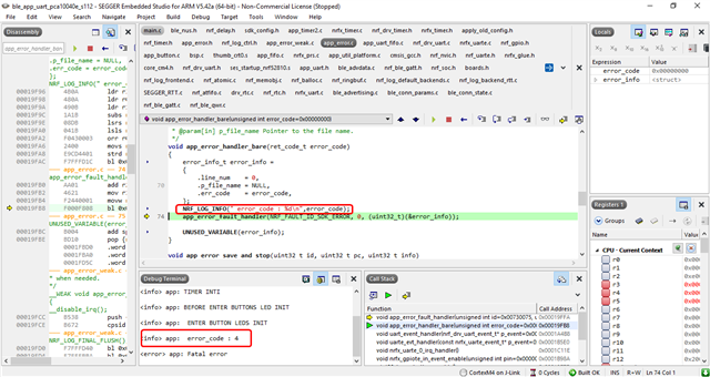

  • hi    ,
    As per your suggestion, I have modified the `apply_config()` function in the `nrfx_uart.c` and `nrfx_uarte.c` files. I pulled up the RX pin like this in both drivers:
     if (p_config->pselrxd != NRF_UART_PSEL_DISCONNECTED)
            nrf_gpio_cfg_input(p_config->pselrxd, NRF_GPIO_PIN_PULLUP);
    Now the nRF52810 custom PCB advertises its name, but after a few seconds, the board turns off. I debugged the code and observed that the issue still persists. I am sharing my debug console output for better understanding. You can see the ERRORSRC register values in the picture. Your response is very valuable..

  • I think the settings is ok. Because you can see the advertising of your device.
    Call stack contents shows the error is from uart_event_handler.
    Can you use break point to check the error is from case APP_UART_DATA_READY or other case?
  • hi ,  , , Sorry for the late response. When debugging the code, I am checking the error code before a fatal error. The log indicates error code 4. Is it related to a memory issue? How can I solve this?
    Yes, it's no memory error code. But there are many functions will return this error code.
    You should put the break points in the uart_event_handler and find which function returns this error code.

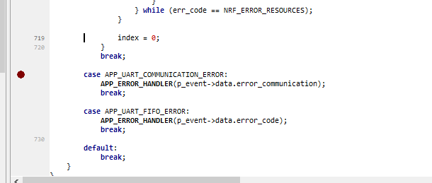

  • hi ,  , ,I apologize for the previous incorrect response. The debug terminal shows that the code enters this specific case. The issue is actually occurring within the UART event handler. What could be causing this?
    case NRF_DRV_UART_EVT_ERROR:
    NRF_LOG_INFO(" NRF_DRV_UART_EVT_ERROR \n");
    app_uart_event.evt_type = APP_UART_COMMUNICATION_ERROR;
    app_uart_event.data.error_communication = p_event->data.error.error_mask;
    (void)nrf_drv_uart_rx(&app_uart_inst, rx_buffer, 1);
    m_event_handler(&app_uart_event);
    You can set break point in app_uart_event.evt_type = APP_UART_COMMUNICATION_ERROR;
    And check UART register's ERRORSRC.
    This document shows error root casue.
    https://infocenter.nordicsemi.com/topic/com.nordic.infocenter.nrf52832.ps.v1.1/uart.html?cp=5_2_0_49_9_3#register.ERRORSRC
