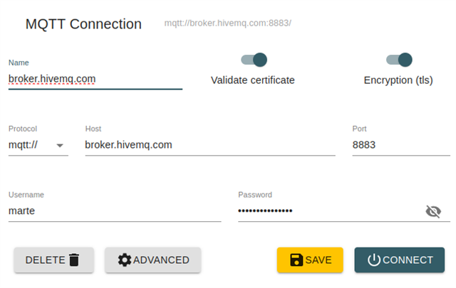

    What host are you trying to connect to? I tested your code with broker.hivemq.com and MQTT Explorer, and it connected successfully.
    If you are testing against your own server, can you first check if you are able to connect to it using, for example, MQTT Explorer? Then you can verify that the certificate, username, and password are correct. Depending on the server, you might also need to provide client certificate and key in addition to the server certificate.
