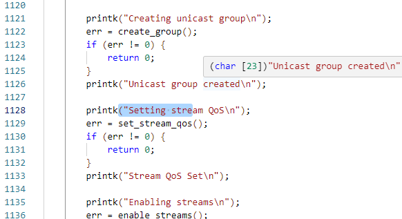

I followed this link is (Missing Forum Thread)
The nRF5340 DK is configured as a unicast audio client, and the nRF5340 audio DK is set up as a headset. However, I'm unable to get the sample audio from audio dk board, having trouble setting the QoS.
Could you please verify the attached logs?

Configuring streams
Audio Stream 0x20003ca4 configured
Configured sink stream[0]
Audio Stream 0x20003ccc configured
Configured source stream[0]
Creating unicast group
status=0
Unicast group created
Setting stream QoS
QoS: waiting for 2 streams

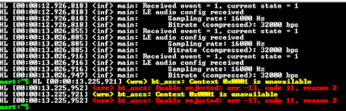

Hi Nordic,
I was shared the nRF5340 Dk unicast audio client, In nRF5340 Audio Dk board i'm sharing , in that i'm getting error as Enable rejected,
could you please help on this to rectify the error.
Thanks.
