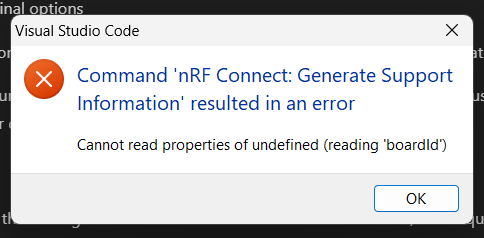

Tried to select General Support Information icon and received:

    Is there a different way to get a user report when the Generate Support Information icon results in:

  • Hi Dejan,
    I get this pop-up when using Command Palette to generate the support information. Are you aware of what may cause this?

    I feel at this point it may be better for me to try and reproduce this again. Though if you have information regarding the pop-up error when trying to generate support information from command palette then that may shed some light for me in the future.
  • Hi Michael,
    According to VS Code team, boardid error could come from the use of stable release. Please try to reproduce the behavior using pre-release version of the extension and make sure that you do not have nested directories. You could also try to open https_client sample in a separate VS Code window.
