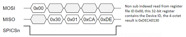

I was struggling with the SPI communication to get the Chip ID by sending a simple 0x00 byte through the MOSI line. I have tried with nrfx_spi alone, but
no success for now. I share my code, which is written in zephyr, it should work but I always receive a 0xFFFFF. I tested the qorvo module with arduino and
it seems to work fine, as I am getting the expected results; as a result, the problem seems to be my code or the board. (I am using the NrfConnect for VScode)

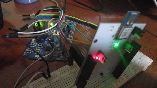

  • Hi, Simonr
    Thank you so much for your rappid reply. Fortunately, I figured out. My first suspicion was related to the code, but then it turns out to be a hardware problem sort to say. I tried connecting the SPI pins to a different port (using &spi1 default pins instead of the ones assigned to &spi2, which are the ones connecting to the board directly). Below I show my set up, it is a total mess but the effort worth it. Now, I am able to communicate succesfully using SPI. For anyone reaching this thread, you can check the example code for communicating with this Qorvo module using zephyr in my github: https://github.com/EmbeddedRick/NRF52832_deca1000_SPI.git
