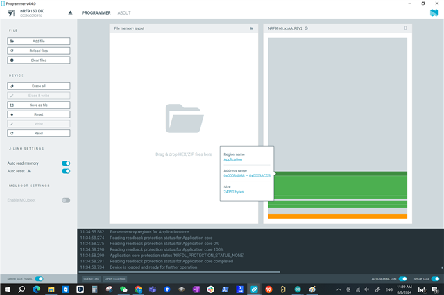

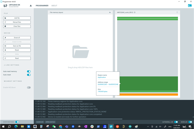

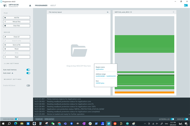

    Now it is time to retrieve the data from nrf91 and forward it to nrf52. But when I check the device memory layout of nrf9160, specifically the downloaded nrf52 part, it doesnt follow the same layout as it is before in the nrf52840DK, which make it tricky to retreive the data from nrf91 and forward it to exact where it should be in the nrf52840DK.
    Any idea how to fix it?
    Thanks
    /CJ
    Below I attach the pictures of how the memory layouts look like before and after downloading the nrf52 firmware to nrf91.
    1.nrf9160DK before downloading nrf52840 firmware
    2.nrf9160DK after downloading nrf52840 firmware
    3.nrf52840DK with nrf52840 firmware, note that there is a settings_storage at the top of the layout
    and it is moved to other places after downloading to the nrf9160DK.
    Then can you not just handle that specific part manually?
