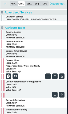

My first question is:
1 a) I want to remove all other services, and I have been able to remove the hr-service and battery-service, however I can not remove the cts-service because then the project won't build properly. Meaning I can't remove the cts.c and cts.h files without something going wrong, can this be fixed somehow?
Now to the GATTClient, I have used the central_hr sample to try and set up my central/client device. This is what that code looks like:

  • Hello Hung!
    1: No that is the problem, if you see this screen shot from my nrf connect app:
    The service found is correct, but the attribute table is wrong right? I should not see the current time service here?
    I have watched these examples, is there something wrong in how I do it in my code?
    Yes I have looked at that course and this problem isn't really discussed as I understand that a service needs to be announced and the characteristics hold attributes. But since I don't use the cts at all I don't understand why it shows up in my attribute table in nrf connect?
    2: Thank you! This is the first up to date useful guide I have been given. I will check this one and see if it helps me. However I am not interested in using the NUS so are all these functions in your tutorial applicable if you don't want to use NUS?
    Please show the whole attribute table. Do you see your FROG service ?
    If you flash a sample, for example the NUS sample, do you see the issue ?
    I suspect that the Attribute table has been cached from the previous application you flashed on the board. You can try to turn off and on  Bluetooth on the phone, also remove bonding if any. Please try to use another phone or use NRF Connect on PC to check.
    Our suggestion is that you go through our tutorial with the NUS sample to get familiar with the SDK before you move to your own code.
    Converting NUS to your service should be straight forward after you managed to make the client/central firmware works.
