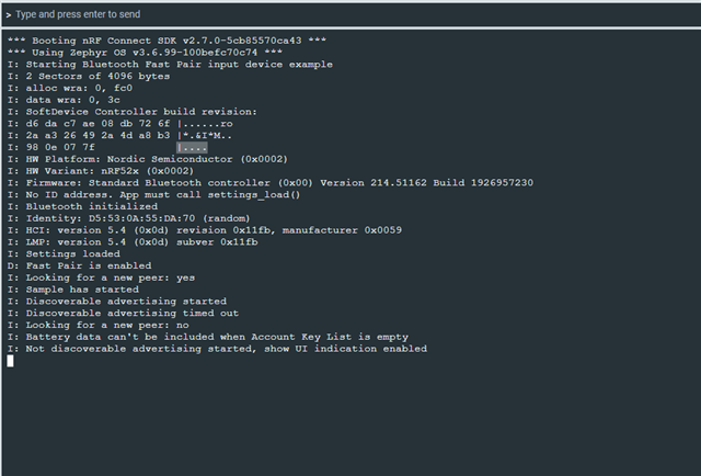

I am currently using the pixel 7a and the Samsung s23 ultra both are connected to the internet and Bluetooth I turned on
But after programming the device I see the device is advertising but the fast pair pop-is not popping up on the phones

    Let me know if it doesn't work in NCS v2.7.0. In that case, please share your build log and your nRF52840's (uart) log.
    Edvin
  • I tried with 2.7.0 still i don't see any pop up
    UART LOGS
    Build logs

  • Hello Nandy,
    Can you please try to register an account with Google and use your own Model ID and spoofing keys?
    And can you please try out the unmodified Fast Pair: Input Device sample from NCS? Does that work with: 1: Debug keys from nordic, and 2: your own keys?
    BR,
    Edvin
  • Hello Edvin,
    I am using the default  Fast Pair: Input Device sample without any changes,
    If I use any of these model id (https://github.com/DiamondRoPlayz/FastPair-Models) I can see the pop up but because of the wrong antispoofing key, it fails.
