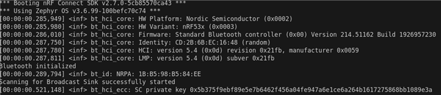

    thank you very much for your answers. I followed your instructions to program the broadcast_audio_assistant app into the nrF5340 audio DK,
    Now I'm using 2 nrF5340-audio-DKs :
    • one DK playing the role of the gateway and running the Broadcast source app
    • one other DK playing the role of the Bluetooth assistant and running the broadcast_audio_assistant app
    Now, I have other issues :
    1) the assistant DK should detect the service 'NRF5340_BROADCASTER' published by the Broadcast source DK. Why the assistant doesn't react at all in the logs ?
    2) the headset (set of LE Audio Broadcast capable earbuds) should connect (or pair) to the assistant DK, why I don't see it in my provided logs above ?
  • It might be that the earbuds are connected by some other devices, or maybe the earbuds advertise a different name. Could you check that?
    Since the broadcast assistant should be able to scan and connect with one of the earbuds
    The name of the earbuds is correct. And they are not connected to any other devices.
    Even if the preconfigured filtering is removed from prj.conf, it doesn't change anything in the logs of the broadcast_audio_assistant app.
    According the code, broadcast_audio_assistant app will at first search for and connect to the first broadcast audio sink found.
    this step seems not working because it doesn't even detect your nordic DK as a sink (nrF5340 Audio DK) which runs the broadcast_sink app.
    Which means with nordic headset or non-nodic earbuds, the result is same. No reaction according the logs:
    Best Regards.
    Due to this line in the broadcast_audio_assistant, it could be that the earbuds don't advertise the needed UUID, so the broadcast assistant cannot find it. You could try to comment out Line #334 and #375 in this example.  It would work because it would check the advertised name again

  • Thank a lot for your help, adjusting the code of broadcast_audio_assistant app did help. here the resulting logs:
    [00:00:25.317,535] <inf> bt_id: NRPA: 32:98:84:94:64:98
    Scanning for Broadcast Sink successfully started
    Broadcast Sink Found:
      BT Name:
    'MOMENTUM' not found in names
      BT Name:
      BT Name:        MOMENTUM TW 4
    Match found for 'MOMENTUM'
    Connecting to Broadcast Sink: MOMENTUM TW 4
    Connected: 47:6B:23:F0:CF:EB (random)
    [00:00:27.807,678] <inf> bt_smp: SC LTK: 0xd9c530b7db3baf6348ecb61780503ae4 (No bonding)
    Security level changed: 2
    BASS discover done with 1 recv states
    [00:00:28.019,775] <inf> bt_id: NRPA: 0D:70:97:2C:3B:42
    Scanning for Broadcast Source successfully started
    Broadcast Source Found:
      Broadcast Name: NRF5340_BROADCASTER
      Broadcast ID:   0x96a0b5
    Match found for 'NRF5340_BROADCASTER'
    Selecting Broadcast ID: 0x96a0b5
    Attempting to PA sync to the broadcaster with id 0x96A0B5
    Scan stopped, attempting to PA sync to the broadcaster with id 0x96A0B5
    [00:00:28.107,299] <inf> bt_id: NRPA: 1B:47:71:82:6B:30
    Waiting for PA synced
    bt_le_scan_stop failed with -120
    PA sync 0x20002324 synced for broadcast sink with broadcast ID 0x96A0B5
    BASS add source successful
    I was able to hear the music broadcast into the earbuds at the first attempt  Smile (but with a poor sound quality).
    But unfortunately, afterwards from the 2nd attempt, I was not able anymore to hear anything and to reproduce the same result...
