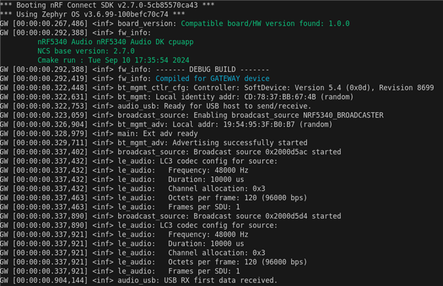

  • Why this ticket has been closed ?
    this use case has nothing to do with the Unicast Client which implements CIS gateway mode. I'm testing here the Auracast mode which implements BIS gateway mode.

    Can please inform me if we need an intermediate "Broadcast Audio Assistant Device" for this Use-Case ?
  • Sorry for misunderstand the issue.
    No, The BIS gateway can function independently, broadcasting one or more audio streams from a source device to an unlimited number of receivers that are not connected to the source. See the test section in the Broadcast source sample.

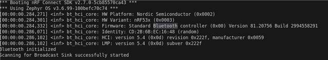

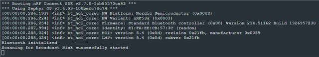

    Since this is a Zephyr sample, it would not load the netcore image correctly. You can
    1. in zephyr/samples/bluetooth/broadcast_audio_assistant
      $ west build nrf5340_audio_dk/nrf5340/cpuapp -p
      $ west flash --domain broadcast_audio_assistant  # this make sure we only program the APP, won't touch the NET
    2. in ncs_dev/nrf/applications/nrf5340_audio
      $ west build -b nrf5340_audio_dk/nrf5340/cpuapp -p
      $ west flash --domain ipc_radio                             # only program the NET
    Then you can get the log like this
