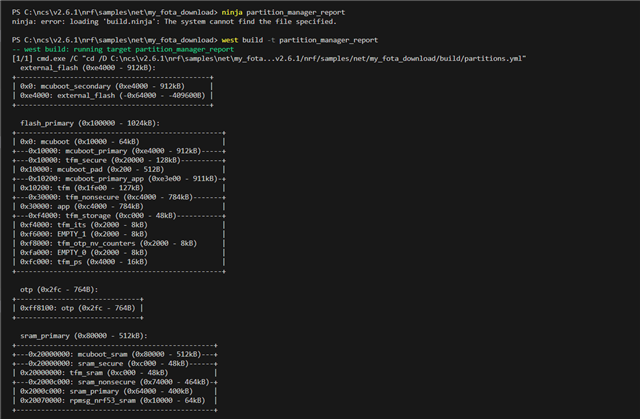

FLASH overflow issue + nrf5340 + DFU external flash
Working with the NRF5340-nrf7002 and the W25Q16RV flash memory in our project.
  • Initially, I configured an 8MB(W25Q64RV) external flash without issues and tested DFU-FOTA which is working as expected. However, after switching to the 2MB W25Q16RV flash, I’ve encountered a flash memory overflow.
  • When configuring the project to use the 2MB W25Q16RV flash, the linker reports a FLASH region overflowed by 736 bytes:
Here I share build i suspect

  • The project works fine with an 8MB flash, but not with the 2MB flash, even though the external flash is only used for FOTA image downloads.
  • I need guidance on whether this overflow issue is due to the flash configuration or another underlying cause.
  • Could you please provide insights on the correct configuration for the W25Q16RV flash to resolve the overflow issue?
  • Any recommendations or adjustments to ensure the 2MB flash works without overflow.

    build/zephyr/partition.yml file
    EMPTY_0:
      address: 0xfa000
      end_address: 0xfc000
      placement:
        after:
        - tfm_otp_nv_counters
      region: flash_primary
    EMPTY_1:
      address: 0xf6000
      end_address: 0xf8000
      placement:
        after:
        - tfm_its
    app:
      address: 0x30000
      end_address: 0xf4000
    external_flash:
      address: 0xe4000
      end_address: 0x80000
      region: external_flash
    mcuboot:
      address: 0x0
      end_address: 0x10000
      placement:
        before:
        - mcuboot_primary
    mcuboot_pad:
      address: 0x10000
      end_address: 0x10200
      placement:
        before:
        - mcuboot_primary_app
    mcuboot_primary:
      address: 0x10000
      orig_span: &id001
      - tfm
      - app
      - mcuboot_pad
      span: *id001
    mcuboot_primary_app:
      address: 0x10200
      orig_span: &id002
      - app
      - tfm
      span: *id002
    mcuboot_secondary:
      address: 0x0
      device: DT_CHOSEN(nordic_pm_ext_flash)
      end_address: 0xe4000
      placement:
        align:
          start: 0x4
      share_size:
      - mcuboot_primary

    You can check the settings for 2MB flash to ensure the settings are correct.
    I have check external flash using zephyr/sample/driver/spi_flash_at45. Both 2MB and 4MB are working fine.
    Any other configuration need to check?

    While debuging found that inccompatible number of sectors.
    • Primary Flash (1MB): 228 sectors detected
    • Secondary Flash (4MB): 128 sectors detected
    1. What are the bootloader settings, especially regarding the flash size and sector layout?
    2.The number of sectors is typically determined by the total flash size divided by the sector size. How to set these configuration for 2MB or 4MB flash?
  • Are you using the static partition? If so, it seems the size of the primary slot and the second slot are not equal. You can remove the static partition and let the partition manager general the partition automatically and then use that partition.yaml as the static partition.
  • Hi Amanda,
    No, I'm not using the static partition. The partiton.yml which I have attached is automatically generated partition only.
    Here I share the conf and overlay files.

    Error log we facing "W: Cannot upgrade: not a compatible amount of sectors"
    *** Booting nRF Connect SDK v3.5.99-ncs1-1 ***
    I: Starting bootloader

    I need guidance to resolve  "W: Cannot upgrade: not a compatible amount of sectors" error?

  • What is the board name you built for? Try to synchronize the name of the board config/overlay files.
    Board configurations: nrf7002dk_nrf5340_cpuapp_ns
    After change the child_imgae/mcuboot/boards/ conf and coverlay to nrf7002dk_nrf5340_cpuapp_ns and try to build with below configuration.
    Facing compilation error : build_log_1
    Can't able to paste build log here so I have provided in link.
    And als try to build with below configurations
    Facing compilation error : build_log_2
     But I have tried the same code without any changes for 8MB external flash. I didn't face any error like this.
    From your build_log_1, I see the mcuboot uses nrf7002dk_nrf5340_cpuapp as the build target, so the board name for the mcuboot is nrf7002dk_nrf5340_cpuapp. That is the reason it cannot find the SPI in the log. Sorry for the mislead.
    It doesn't need to set the mcuboot board file as the second board configuration, the system would load it automatically according to the board name for the mcuboot.
    You can check out this post regarding the overlay file and this sample.
    -Amanda H.
  • Hi Amanda,
    Thanks for your response.
    Follow the sample/ link you shared, the issues resolved, 2MB and 4MB flash is working fine.
