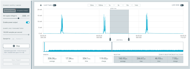

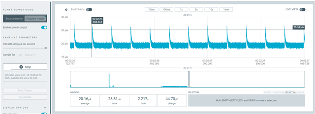

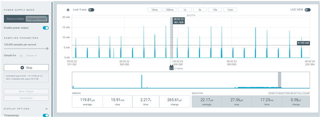

Hello, I am using the peripheral_lbs example project and build it for nrf21540dk_nrf21540
I also added CONFIG_SERIAL=n, CONFIG_UART_CONSOLE=n for disabling uart.
But still i couldn't able to get <=3uA sleep current.
Do i have to enable/disable something to get sleep current??
I measured power consumption by following steps as instructed in nordic documentation:
1. Cut SB40 bridge
2.provided connection acc. to the diagram
3.Set the ppk to ampere meter mode and enabled the power output
I even tried in both nRF only and Default modes (toggle switch in DK), but still couldn't see any much difference.
What should be done to get <=3uA sleep current in nrf21540DK??
