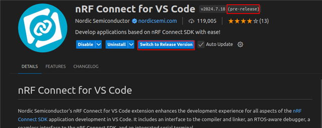

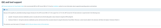

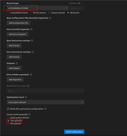

  • I'm sorry, I was certain that I built the project with SDK v2.6.1, but I see now that I actually built it with SDK v2.7.0. When building with SDK v2.7.0, please make sure you use the pre-release version of the VS code extension:
    This is needed to work with sysbuild (Migrating from multi-image builds to sysbuild) and the new HW model (igrating to the current hardware model). From the release notes:
    Build configuration:
    Note: Sysbuild is enabled by default if you use West to install a new SDK, but not if you update your existing SDK with git checkout and west update. Therefore, you may want to explicitly enable it in the project configuration as shown above. (Sysbuild enabled by default)
    The partition manager gets enabled by default, which is why the storage partition got assigned a different starting address (0xfa000 vs 0xf8000).
    Here's an updated version of the project:
    littlefs_2.7.0.zip
    This version includes the custom cmake commands to create the littlefs filesystem image. The generated littlefs_image.hex can be found in build/littlefs_2.7.0. I did not manage to find a way to automatically merge it with the zephyr.hex, so it still needs to be programmed separately.
