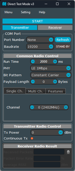

nRF52833 DTM does not work
I am trying to do CE, FCC RF test.
I am using nRF52833 and nRF5_SDK_17.0.2_d674dde.
I want DTM to work. DTM is using example source in SDK. What changed in example source is UART communication port.
static void uart_init(void)
uint32_t err_code;
const app_uart_comm_params_t comm_params =
NRF_GPIO_PIN_MAP(1,00),
NRF_GPIO_PIN_MAP(0,13),
0,
0,
APP_UART_FLOW_CONTROL_DISABLED,
false,
DTM_BITRATE
And, control power and LED according to our board characteristics. void it23_board_init(void )
nrf_gpio_cfg_output(NRF_GPIO_PIN_MAP(0,8)); // power hold
nrf_gpio_cfg_output(NRF_GPIO_PIN_MAP(1,4)); // power led
nrf_gpio_pin_set(NRF_GPIO_PIN_MAP(0,8)); // power hold set
nrf_gpio_pin_set(NRF_GPIO_PIN_MAP(1,4)); // shock led turn on
I've attached main.c.

I compiled this DTM and uploaded it to the board.
I connected it to the PC and UART (Tx, Rx, Vcc3.3v, GND).
On the PC, I used the nRF-DTM UI-based below.
https://github.com/olleheugene/nRF-DTM/wiki/UI-based-test
I saw the result as shown in the picture below.
After checking up to this point, I sent the product to the test lab.
However, the test lab saw the output like the picture above, but it is not captured by the actual wireless test equipment.
What is the problem? Is there any way to check if the DTM works without the wireless test equipment?
