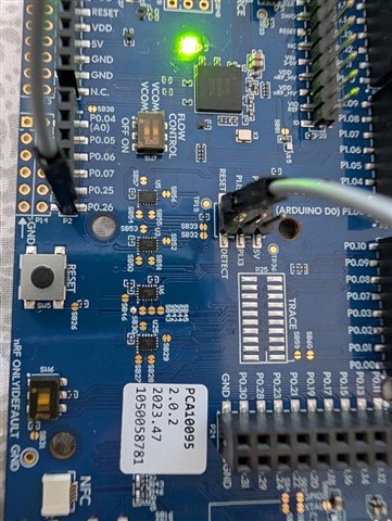

    I also tried connecting the RESET pin directly to a GPIO to trigger a pin reset instead of a software reset. However, when I attempted this, our custom board freezes after setting the GPIO low, I think its because the RESET pin remains low.
    This should work, but it is important that the GPIO is never becomes configured as an output low during boot. Is this GPIO configured in the code your prodived?
  • Thank you for this example. I'm able to reproduce the same here now, and it looks like the program hangs in the SPU_IRQHandler when the WD times out.
    Great to hear you can see it your side too.
    It isn't in the demo I provided, however, it can be added easily.
    On the DK you just need to add a solder bridge to SB43 so the reset can be controlled via the pin, then add a jumper between a gpio and the RESET pin.
    I've used GPIO (0,26) below)
    Then you can add the following function to the demo example which triggers a pin reset.
    #define CONTROL_PIN NRF_GPIO_PIN_MAP(0,26)

    In my testing I call pin_reset() in main after the 2 second delay and led initialisation.
    It seems like because the reset pin never goes low again it doesn't complete a reset. You can see this using the "Boot Reset" button on the DK; if I hold the button down the device won't reset, It's only when I release the button does it reset.
    I think you are right. The specification does not guarantee the pin state in reset, only when going out of reset. I know this approach with using a GPIO to trigger pinreset worked with the nRF52840 but there are some differences in the reset mechanism between the nRF52840 and the nRF5340.
