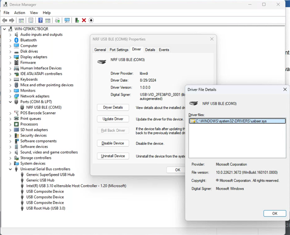

We developped a firmware on the nrf52840 dongle able to communicate with a Windows PC through the USB.
On Windows 10, we can communicate with a serial COM port. The dongle is listed as a COM Port (twice but both work).
On Windows 11, the dongle is badly listed as USB device and to get a COM port we need to create a legacy hardware COM Port. Once this is done, we see the COM Ports but no way to communicate, at any speed.
I know it's more a Windows issue than a Nordic one, but if any of you encountered this kind of thing, please let me know how you solved it.
We tried to reconfigure drivers and all, no more success.
