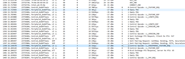

  • Here are the logs and sniffer packets before the sniffer halts and no longer captures packets. Upon disconnect, it's configured to automatically start advertising again and the RPA then changes.

    With the nRF connect mobile app I can properly us the SC LTK to decode encrypted messages in Wireshark. I see no issues there.

    In any case, you should upload more sniffer logs from more attempts than just a single one. It appears the central Bluetooth controller fails and drops the connection upon receiving the LL_PHY_REQ from the peripheral, which seems to be a bug in the central Bluetooth controller. You should file a bug report to Intel if you can repeatedly reproduce this.
    One question though to the Nordic team is why the peripheral sends an additional feature request to the central when it moments ago already received the feature set from the central.

    Regarding the PHY updates, I captured the packets for pairing 3 more times. Out of the four total, two fail after the LL_PHY_REQ (peripheral -> central) and two fail after LL_PHY_UPDATE_IND (central -> peripheral) so it appears it's not just an issue with the central.

  • In the LL_PHY_UPDATE_IND, we can see that the Instant is set to 0, which is not valid (or at least not a sane value, since it represents an event in the past). It feels like they forgot to assign the value a proper value. So please report this bug to Intel who makes the Bluetooth chip in your computer. Or maybe see if there is a firmware update for your Bluetooth chip on your PC?

    Regarding the firmware bug, my Bluetooth driver was outdated. On windows device manager it did not indicate or detect any updates and I had to navigate to the intel website to determine this. Upon updating, that problem is resolved and pairing works without disabling PHY updates in peripheral firmware. BLE_Windows_Secure_Fixed.pcapng
