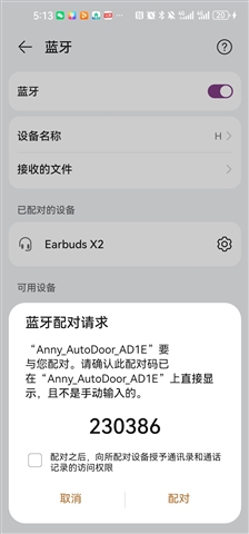

    I already set CONFIG_BT_FIXED_PASSKEY=y and use bt_passkey_set() to set the static passkey.
    But I think the relevant code that I used is misfit to the way that use the passkey.
    I imitate the hid_mouse that use bt_conn_auth_cb_register() and bt_conn_auth_info_cb_register() to replace the peer_manager in nRF SDK17.
    I think it is the issue that even CONFIG_BT_FIXED_PASSKEY=y and bt_passkey_set() be used,the pairing show in my phone still display a 8 length passkey and confirm 、cancal button rather than a input box just like this:

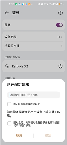

    And that's what I want to achieve:
