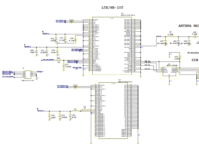

    Other problem is when I flashed my custom board I can't communicate my stm32 micro with the nrf9160 module via uart.. but when I flashed my nrf9160DK with this build I can communicate using terminal through FTDI wire put in the same uart pins..
    Here is the schematic of my custom board:
    schematic_custom_board.zip
    is something wrong in the design?
    thanks for your help!
    Regards, Alex

    Could you please upload a higher resolution of the schematic ? Preferably as pdf file instead of png.
    Please give more info about the code Charlie provided. Besides the warnings do you have any issue , does it work as it should ?
  • Hi Hung,
    thanks for your response. Here si the full schematic:
    DFR8RAILOG_WNODE_v0.pdf
    The solution that Charlie provided working with the nrf9160DK but not with my Custom board. I'm trying to communicate the nrf9160 SIP with STM32 MCU via uart2 but is not working and I think there something that I'm missing..
    Here are my custom board files:
    2273.nrf9160_sica_b1.zip
    0844.custom_board_nrf9160_ns.conf
    6283.custom_board_nrf9160_ns.overlay
    I need to do a field test using nrf9160 LTE communications next week, so I appreciate any help.
    Alex
  • Hi Alex,
    Have you verified that there is no problem with the hardware ?
    Have you tried to toggle the uart2 pins as GPIO pins ? Just do a quick test if you can change the level of the pins.
    If it work, please try to test with a simple UART sample and use a logic analyzer to check if you have correct UART output on the pins.
    After that you can start to try testing with the serial lte modem sample.
  • Hi Alex,
