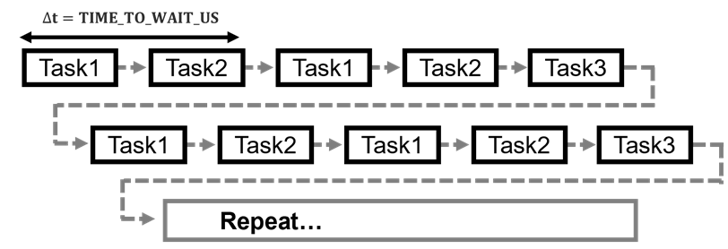

[SPIM + NUS] conflict between the SPIM and BLE thread.
I am programming with the nRF52840DKs. [Toolchain Manager: v1.3.0, IDE: Visual Studio Code (VSCode), SDK: ncs v2.6.0, window11 pro]
I am currently working on integrating 'NUS_peripheral' and 'SPIM'.
My goal: communicate with the ADC via SPIM and transmit the collected data via Bluetooth.
To briefly explain my code, the SPIM turns on and off at regular intervals using a timer. The NUS (peripheral) sends data through a while loop.
However, it seems that there's a conflict between the SPIM and the while loop in the BLE thread.
Below are the main code:

  • First of all, thank you so much for your response.
    When using SPIM alone, there were no issues, and all debugging has been completed. Additionally, even when NUS and SPIM used separate buffers, the tests were conducted and everything worked fine in that case as well. (Additionally, I measured SS, SCK, MOSI, and MISO with an oscilloscope to confirm this.)
    The problem arises when the buffer is shared between the SPIM handler and the NUS thread. SPIM itself operates correctly, as confirmed by the oscilloscope, but sharing the buffer became unavoidable when I tried to send the data received by SPIM to NUS.
    To address this, I implemented double buffering. However, I'm facing difficulties in writing the code due to the limitation that I cannot wait for or block the handler(in zephyr OS).
    Please try to do a memcpy to copy the SPI buffer to another buffer before sending as the BLE stack will not buffer it until it's sending. So if the content of the buffer is changed/updated before the BLE packet is sent you will send the wrong data.
    As you mentioned, are you referring to storing NUS_send_counter in temp like in my code(nus_thread)? I think it's a good idea. However, I'm concerned that memcpy might result in high CPU load.
  • Hello. I followed your advice and coded accordingly. Below are the modified sections, while the rest remains the same as in the previous code

    There are a few issues. The SPIM result for the spim_tx_buf_initial command is missing, and only the result for spim_tx_buf_repeat is printed to NUS. To address this, I added a few variables for debugging as shown below.(The commented-out section is the part that has been modified.)
