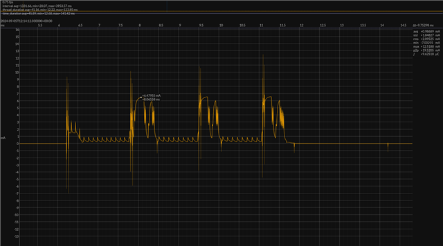

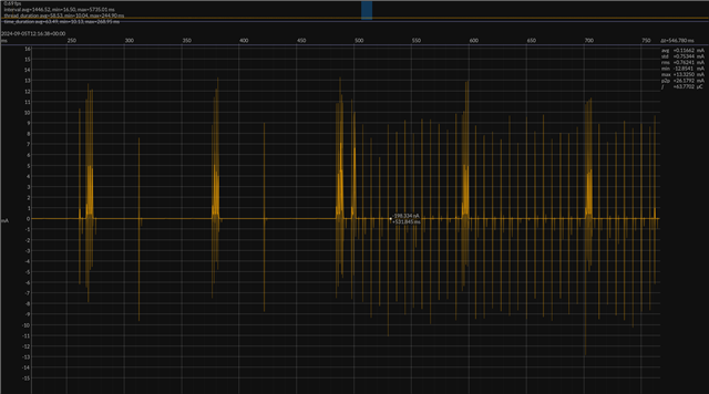

Higher power consumption During advertising than online profiler expects
Screenshot from joulescope, average power consumption is around 92 uA (top right corner). No DM activity here.

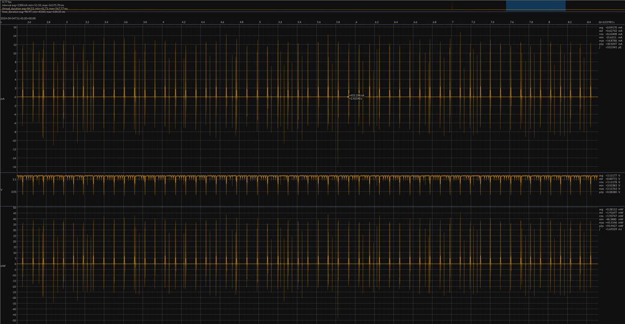

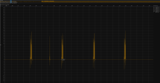

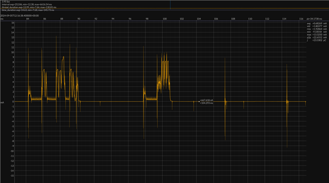

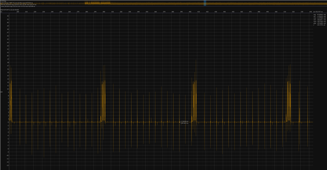

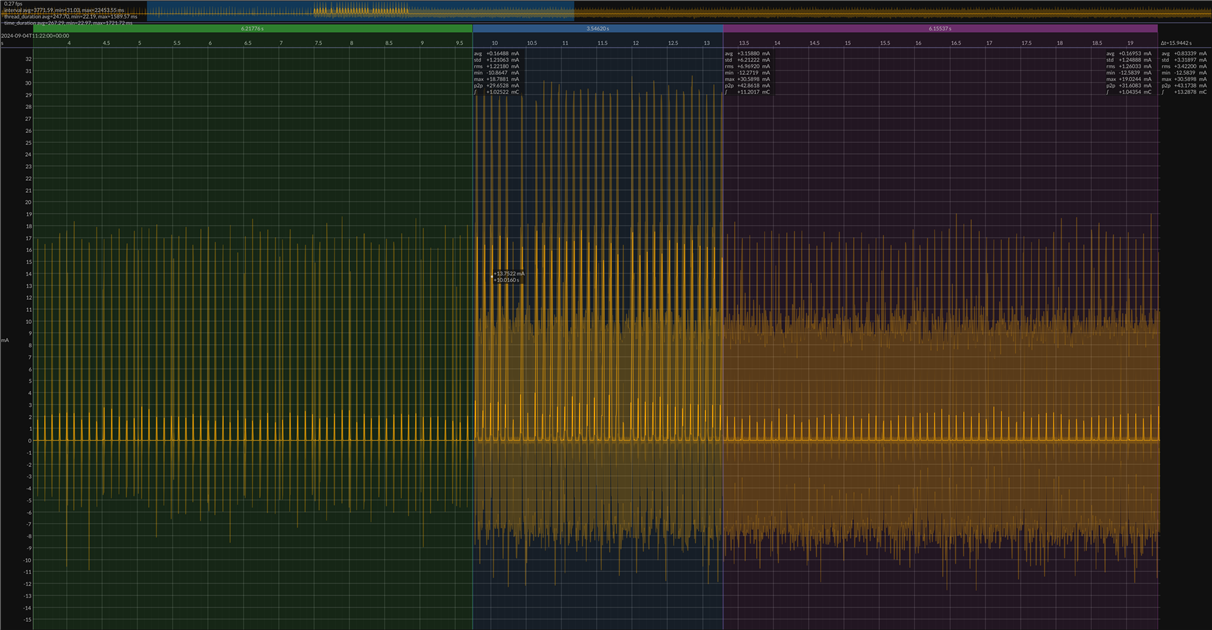

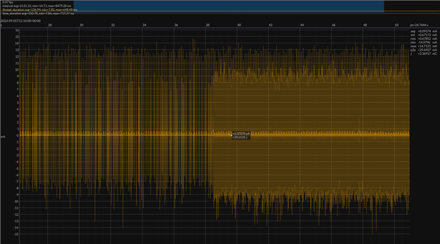

Increased power consumption after distance measurement
When we make power on reflector and several distance measurement are made, power consumption never returns to original value.
To me, it looks like MPSL is started with first DM and then keeps waking MCU even though there is no need for more scheduling.

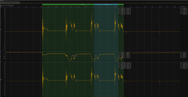

Green - advertising before DM
Blue - advertising + DM
Purple - advertising after DM
Details of advertising before and after DM (ignore slightly different time scale)
