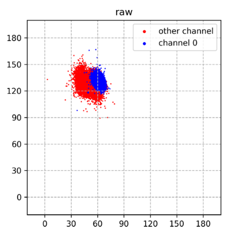

    I plot out the calculated AoA for a raw I/Q data recording with rx at a fixed position. In this test I used the 2X2 antenna for 2-D direction finding, AoA are calculated independently for the two axis, and are plotted in pair as (x_aoa, y_aoa) in degree. I marked out AoA calculated from CTE reports with channel=0 as blue dots, and the rest as red.
    As you can see, there is non-negligible bias between the dots.

    So first of all, this seems like a bug somewhere. And the bias you are showing there does make this more evident. Are you using the provided channel IDs when calculating these results, or are you using the presumably correct first channel ID for all the results, both blue and red?
