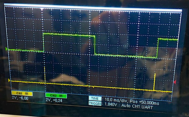

No matter how many bytes are transferred. From one to 200, the transmission length is about 60 ms. If you start loading new data at this interval, the packets disappear. Instead of 1ms, it takes 60 times longer.
I have studied the topic devzone.nordicsemi.com/.../how-to-achieve-max-throughput-with-nus-service
Implemented all the recommendations from it. But it does not solve the problem. If you use NRF_SDH_BLE_GAP_EVENT_LENGTH more than 6, the application immediately fails.
The yellow line in the picture: the residence time in the BLE_PeripheralSend() function This is 60us. This is followed by waiting for packet transmission, green line. This is not less than 40ms and not more than 60ms. A packet cannot be shortened in any way, even if it is 1 byte.

    I'm not spinning in that cycle. The output from there is no more than 60us. CLRBIT(TEST_PIN2);
    That's the bottom line. But the event BLE_GATTS_EVT_HVN_TX_COMPLETE: comes after 60ms already

    This would make sense if the packet is longer than 20 bytes. I tried sending: 1, 2, 4, 8, 16 bytes in one call of BLE_PeripheralSend(). The busy length (Green line) does not change and is strictly equal to 60ms.

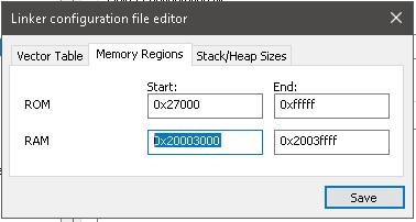

    Increased the memory size. NRF_SDH_BLE_GAP_EVENT_LENGTH = 60  Now the application does not crash. But the transfer speed did not increase. Transmission time of one packet is still 60ms.
