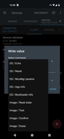

I am attempting to use the nRF Connect for Mobile application to test the MCUmgr implementation on my device running the Softdevice.
I am able to successfully run the "OS/Echo" and "OS/mcumgr_params" commands, but "OS/bootloader_info" never gets through.
As unlikely as it seems, this appears to be an issue at the Softdevice controller level based on the Wireshark traces I have collected.
The central device is repeatedly sending the command, with no acknowledgement from the Softdevice.
    I'm unsure how to run those commands since I cannot find relevant docs. Could you elaborate on the details?

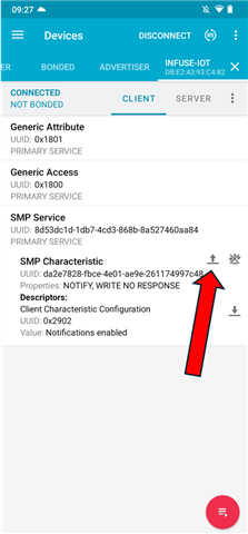

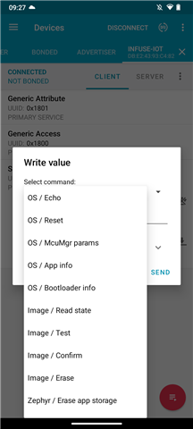

  • I don't understand what you mean? You are unable to find the same menu in the app?
    The one step I did not include because I thought it was sort of obvious is that you need to tap the "SMP Service" row to expand out the two characteristics.
    If you mean some other problem, you will have to include a screenshot because I can't see any way for this to go wrong.

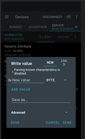

  • (Update)
    My colleague can get the same menu in the app on his pixel 4a.
    He ran the "OS/bootloader_info" command and got the result as the following figure. Also updating via DFU works as expected without issue.
    What is your destination? If you just want to update via DFU, this command is not necessary and will not impact the DFU.
    What is the phone you use? I use Pixel 6a with Android 14, but cannot find the same menu in the app as you.
    Could you try to use the nRF Device app?
