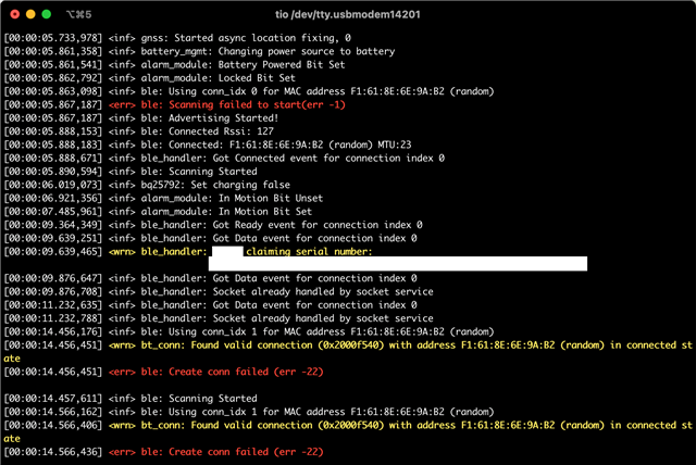

  • Hi Vidar,
    So, moving to the new Softdevice has been relatively good --
    However, I have come across two cases where the softdevice says there is a connection to a peripheral, where the peripheral has long since been removed, and the other side says the link is disconnected.
    This prevents reconnection, because internally it thinks there is already a connection.
    Our application tracts connected and disconnected events, and we show 0 connections at this point, however it seems conn_idx 0 is stuck in the softdevice as it is trying to use conn_idx 1 for a new connection.
    My understanding is the LL layer should have cleaned this up into the disconnected state, even if our application forgot to unref it?
    Wondering if you had any input!
    -- Jeff
  • Hi Jeff,
    The app is responsible for releasing its reference count on disconnect, or after a failed connection attempt. Otherwise the connection object will not be freed by the host even if the link has been terminated. However, I'm unsure why it reports that it is in the connected state, not the disconnected state. Have you tried testing your app against the v2.8.0-rc1 tag, or did you only update the Softdevice library?
    Vidar
  • Vidar,
    We're using a heavily updated ncs v2.7.0 to keep up with upstream, we pulled in the softdevice from v2.8.0-rc1 (and tested the newer recently updated one).
    I double checked my application, and I don't see any holes where a conn will not get unref'd, even with any conn errors --
    We tracked it back down to a missing disconnect event again. The connection stays in the connected state internally.
    In lieu of any alternate suggestions that come up, we're planning to run our tests again when v2.8.0 is out, and we can merge our patches again.
    --Jeff
