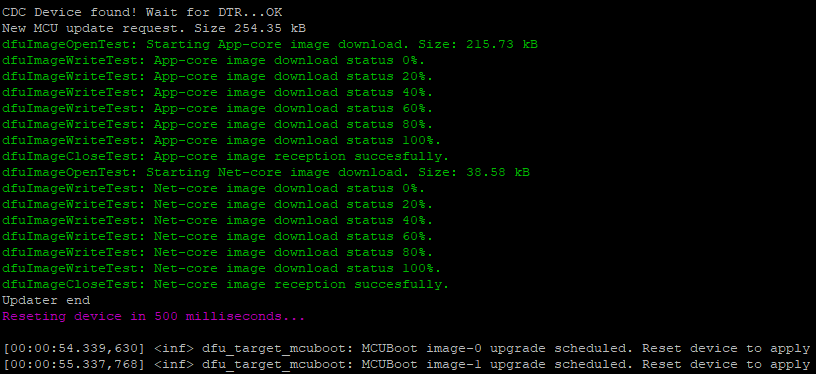

This is working fine as you can see from this log
The problem is that only the application core is getting updated
It's like MCUboot detects that there is a new image on index 1 (network core) but ignore it.

  • build/zephyr/dfu_application.zip only contains app_update.bin and manifest.json in my case, there is no file for netcore
    If I understand correctly I'm writting the appcore and netcore images correctly, I just need to MCUboot to perform the netcore image swap

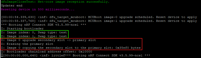

    Appcore logs during boot:
    *** Booting nRF Connect SDK v3.5.99-ncs1 ***
    I: Starting bootloader
    I: Image index: 0, Swap type: test
    I: Image index: 1, Swap type: test
    I: Image 0 upgrade secondary slot -> primary slot
    I: Erasing the primary slot
    I: Image 0 copying the secondary slot to the primary slot: 0x35ef0 bytes
    I: Bootloader chainload address offset: 0x10000

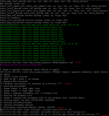

  • Hi Amanda, I work with  , we have been checking your sample and modified some of the configurations in our main project and child images (and verified them in the built zephyr/.conf files), but still can't get the updater to trigger the network core update.
    The main structure of our project is described here, to summarize:
    • only 1 project, with main application core firmware
    • network core firmware being built as a child image of the application core
    • mcuboot enabled in application core through prj.conf
    • mcuboot included in network core as described here, with an extra b0n.conf being applied in our network core project folder, inside child_image folder
    Adding a little more verbosity, the logs from application core during updating process are the following:
    and in the network core we can see the B0N bootloader banner, and the application banner:
    I understand that your sample works with the HCI_IPC sample for network core, do you think it is possible that some configuration from that sample can be missing on our side to enable the network core update? Is there any advice on particular configurations to look for? considering we are already following what is described here and here, and there are no big differences with your sample project (except for working without BLE, and not basing the update on FIRMWARE_VERSION but just forcing it to always execute).
    Leopoldo.

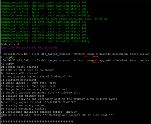

    Did you make any changes to the HCI_IPC sample for the network core to update? If the code is the same, it will not be updated. You can try to add
    printk("build time: " __DATE__ " " __TIME__ "\n");
    to build with differences.
    -Amanda H.
