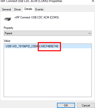

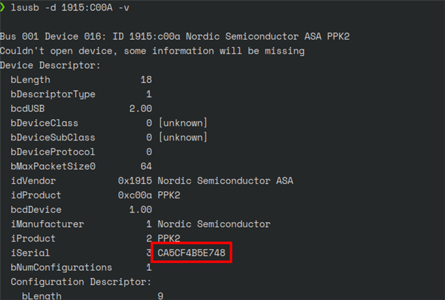

    The serial number as a part of the USB device descriptor. There are multiple ways of read this info.
    In windows you can find it in the "parent" property found in the device manager:
    The PPK2 will show up as a serial COM port.
    In linux you can use lsusb -d 1915:C00A -v

  • Hi Bendik,
    I somehow missed it when I (tried) to inspect all the properties earlier, I am able to see the "Parent" property Value similar to how you show, and my SN# is F0D53E50C7CD
