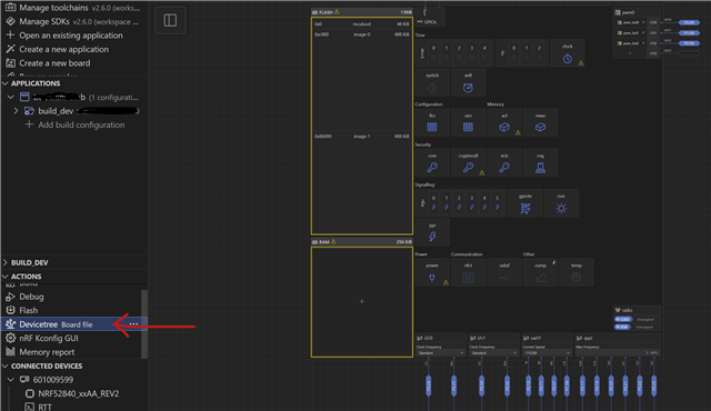

    Also make sure that all un-needed peripherals are disabled in a board overlay file. You can check this quickly by either reading the zephyr.dts file in you build/sephyr folder to check for anything that has status="okay" that you arent using. Or you could use the dts visualizer tool and just click stuff to turn them off (which makes or edits the overlay file previously mentioned).
    If you dont have any peripherals that need GPIOTE make sure that is status="disabled". If you have to have gpiote for one of your peripherals and you have an interrupt to handle like your door signal you can use the sense method on it instead of gpiote which will save some power. You can use sense on many low frequency interrupts instead of the task-event method that gpiote uses. You can use the sense-edge-mask property to tell it which pins to use sense on. In the example below, 0x8800 = 0b1000 1000 0000 0000 so I'm telling it to use sense on pins 15 and 11.
    &gpio1 {
    	status = "okay";
    	sense-edge-mask = <0x8800>;

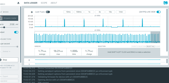

  • Hi Neethu,
    Have you tried to verify the power consumption using one of our DK ?
    Please also try to measure the current consumption with the peripehral_lbs (use prj_minimal.conf configuration in stead of prj.conf) .
    You should be able to se the idle current of a few uA instead of more than 1mA in  you are measuring now. This will also very that the way you measuring the current consumption is correct.
    Thank you for your suggestion. I have tried and verified the power consumption using one of the DKs, and below are the
    current measurements I received. Also ,I require beacon type not the connected one .

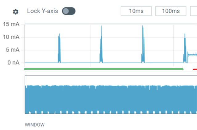

  • Hi Neethu,
    Thanks for the trace. Green part look expected. The idle current is low (close to 0mA) But the red part is quite strange (idle current is about 4mA). For me it seems like the CPU didn't sleep the whole time. So you may want to check if there is something running in the background that keep the CPU awake all the time.

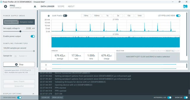

  • I have implemented sleep mode in my BLE beacon project. However, I am still looking for ways
    to further reduce power consumption. I have configured the system to enter sleep mode, but I would like to know if there are additional strategies or configurations that can
    help minimize power usage even further.
    Any guidance or suggestions would be much appreciated!
