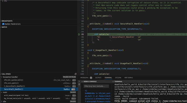

    The secure fault handler is implemented in the TF-M application, not in the main application. But you can start a debug session with the main app and inspect the call stack after the secure fault has been raised.

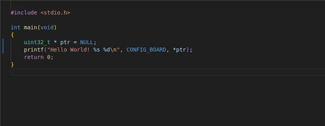

    e.g., dereferencing NULL pointer to trigger a secure fault:
