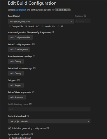

build sid_end_device error

FAILED: zephyr/zephyr_pre0.elf zephyr/zephyr_pre0.map C:/Users/Administrator/sid_end_device_3/build/mcuboot/zephyr/zephyr_pre0.map
cmd.exe /C "cd . && C:\ncs\toolchains\ce3b5ff664\opt\zephyr-sdk\arm-zephyr-eabi\bin\arm-zephyr-eabi-gcc.exe -gdwarf-4 zephyr/CMakeFiles/zephyr_pre0.dir/misc/empty_file.c.obj -o zephyr\zephyr_pre0.elf zephyr/CMakeFiles/offsets.dir/./arch/arm/core/offsets/offsets.c.obj -fuse-ld=bfd -T zephyr/linker_zephyr_pre0.cmd -Wl,-Map=C:/Users/Administrator/sid_end_device_3/build/mcuboot/zephyr/zephyr_pre0.map -Wl,--whole-archive app/libapp.a zephyr/libzephyr.a zephyr/arch/common/libarch__common.a zephyr/arch/arch/arm/core/libarch__arm__core.a zephyr/arch/arch/arm/core/cortex_m/libarch__arm__core__cortex_m.a zephyr/arch/arch/arm/core/mpu/libarch__arm__core__mpu.a zephyr/lib/libc/minimal/liblib__libc__minimal.a zephyr/lib/libc/common/liblib__libc__common.a zephyr/soc/soc/nrf52840/libsoc__nordic.a zephyr/drivers/clock_control/libdrivers__clock_control.a zephyr/drivers/console/libdrivers__console.a zephyr/drivers/flash/libdrivers__flash.a zephyr/drivers/gpio/libdrivers__gpio.a zephyr/drivers/pinctrl/libdrivers__pinctrl.a zephyr/drivers/serial/libdrivers__serial.a zephyr/drivers/timer/libdrivers__timer.a modules/nrf/lib/fprotect/lib..__nrf__lib__fprotect.a modules/nrf/drivers/hw_cc3xx/lib..__nrf__drivers__hw_cc3xx.a modules/mcuboot/boot/bootutil/zephyr/libmcuboot_util.a modules/hal_nordic/nrfx/libmodules__hal_nordic__nrfx.a modules/segger/libmodules__segger.a -Wl,--no-whole-archive zephyr/kernel/libkernel.a -L"c:/ncs/toolchains/ce3b5ff664/opt/zephyr-sdk/arm-zephyr-eabi/bin/../lib/gcc/arm-zephyr-eabi/12.2.0/thumb/v7e-m+fp/hard" -LC:/Users/Administrator/sid_end_device_3/build/mcuboot/zephyr -lgcc zephyr/arch/common/libisr_tables.a -mcpu=cortex-m4 -mthumb -mabi=aapcs -mfpu=fpv4-sp-d16 -mfloat-abi=hard -mfp16-format=ieee -Wl,--gc-sections -Wl,--build-id=none -Wl,--sort-common=descending -Wl,--sort-section=alignment -Wl,-u,_OffsetAbsSyms -Wl,-u,_ConfigAbsSyms -nostdlib -static -Wl,-X -Wl,-N -Wl,--orphan-handling=warn -Wl,-no-pie C:/ncs/ncs/nrfxlib/crypto/nrf_cc310_platform/lib/cortex-m4/hard-float/no-interrupts/libnrf_cc310_platform_0.9.19.a C:/ncs/ncs/nrfxlib/crypto/nrf_cc310_bl/lib/cortex-m4/hard-float/no-interrupts/libnrf_cc310_bl_0.9.12.a && cmd.exe /C "cd /D C:\Users\Administrator\sid_end_device_3\build\mcuboot\zephyr && C:\ncs\toolchains\ce3b5ff664\opt\bin\cmake.exe -E true""
c:/ncs/toolchains/ce3b5ff664/opt/zephyr-sdk/arm-zephyr-eabi/bin/../lib/gcc/arm-zephyr-eabi/12.2.0/../../../../arm-zephyr-eabi/bin/ld.bfd.exe: zephyr\zephyr_pre0.elf section `text' will not fit in region `FLASH'
c:/ncs/toolchains/ce3b5ff664/opt/zephyr-sdk/arm-zephyr-eabi/bin/../lib/gcc/arm-zephyr-eabi/12.2.0/../../../../arm-zephyr-eabi/bin/ld.bfd.exe: region `FLASH' overflowed by 4042 bytes
[235/407] Linking C static library zephyr\subsys\bluetooth\crypto\libsubsys__bluetooth__crypto.a
FAILED: modules/mcuboot/mcuboot_subimage-prefix/src/mcuboot_subimage-stamp/mcuboot_subimage-build mcuboot/zephyr/zephyr.hex mcuboot/zephyr/zephyr.elf C:/Users/Administrator/sid_end_device_3/build/modules/mcuboot/mcuboot_subimage-prefix/src/mcuboot_subimage-stamp/mcuboot_subimage-build C:/Users/Administrator/sid_end_device_3/build/mcuboot/zephyr/zephyr.hex C:/Users/Administrator/sid_end_device_3/build/mcuboot/zephyr/zephyr.elf
cmd.exe /C "cd /D C:\Users\Administrator\sid_end_device_3\build\mcuboot && C:\ncs\toolchains\ce3b5ff664\opt\bin\cmake.exe --build . --"
[253/407] Building C object zephyr/subsys/bluetooth/host/CMakeFiles/subsys__bluetooth__host.dir/hci_core.c.obj
FATAL ERROR: command exited with status 1: 'C:\ncs\toolchains\ce3b5ff664\opt\bin\cmake.EXE' --build 'c:\Users\Administrator\sid_end_device_3\build'
Background: Using default demo sie_end_device without any changes, v2.7.0 SDK,compiling other demos is normal

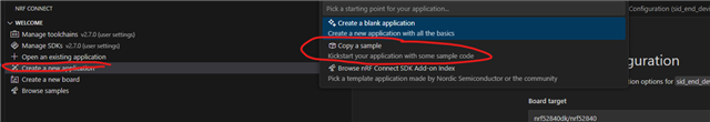

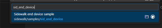

    You can find static partition file pm_static_nrf52840dk_nrf52840.yml inside your sid_end_device project folder but since I cannot reproduce your issue you should probably not focus on this file at the moment.
    You could try to replicate what I have done previously (please refer my previous reply) and build from command line. I have also tried building from VS Code with the same build configuration as in your screenshot and could not reproduce your error. When using VS Code try to add sample as application (do not copy the sample). Both options (building from command line, and from VS Code without copying the sample) work fine on my side.
