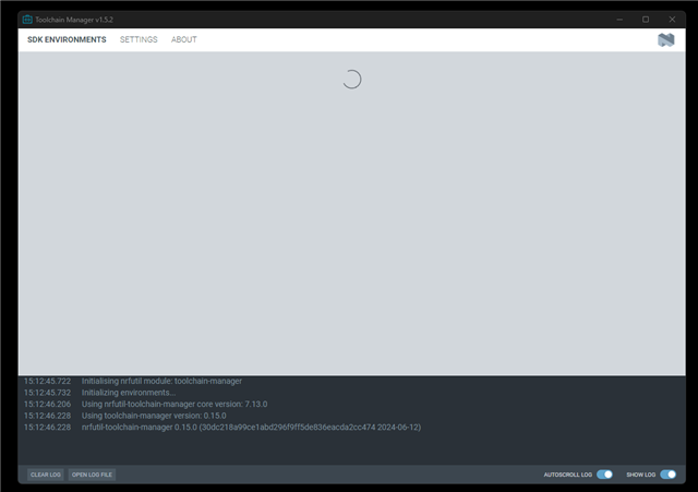

NRF Connect toolchain manager not starting
Hi, I tried to start toolchain manager on my main computer and its not working anymore. I tried to delete all nrf related folders, deleted all apps including nrf connect deskop and reinstalled everything. its still the same issue. I even moved the already installed toolchain folders to a new place, this also didnt help
the window of toolchain manager opens and a spinning wheel never stops
log files:
2024-09-20T13:12:45.722Z INFO Initialising nrfutil module: toolchain-manager
2024-09-20T13:12:45.732Z INFO Initializing environments...
2024-09-20T13:12:45.733Z DEBUG Application data folder: C:\Users\danie\AppData\Roaming\nrfconnect\pc-nrfconnect-toolchain-manager
2024-09-20T13:12:45.788Z DEBUG Sending event "toolchain-manager: running nrfutil toolchain-manager"
2024-09-20T13:12:45.789Z DEBUG App pc-nrfconnect-toolchain-manager v1.5.2 (official)
2024-09-20T13:12:45.789Z DEBUG App path: C:\Users\danie\.nrfconnect-apps\node_modules\pc-nrfconnect-toolchain-manager
2024-09-20T13:12:45.789Z DEBUG nRFConnect 5.0.2, required by the app is (>=5.0.2)
2024-09-20T13:12:45.789Z DEBUG nRFConnect path: C:\Users\danie\AppData\Local\Programs\nrfconnect\resources\app.asar
2024-09-20T13:12:45.789Z DEBUG HomeDir: C:\Users\danie
2024-09-20T13:12:45.789Z DEBUG TmpDir: C:\Users\danie\AppData\Local\Temp
2024-09-20T13:12:45.860Z DEBUG Sending event "toolchain-manager: running nrfutil toolchain-manager"
2024-09-20T13:12:46.170Z DEBUG Sending event "toolchain-manager: running nrfutil toolchain-manager"
2024-09-20T13:12:46.191Z DEBUG Sending event "toolchain-manager: Status of VS Code installation"
2024-09-20T13:12:46.191Z DEBUG Sending event "toolchain-manager: Status of nrfjprog installation"
2024-09-20T13:12:46.206Z INFO Using nrfutil-toolchain-manager core version: 7.13.0
2024-09-20T13:12:46.228Z INFO Using toolchain-manager version: 0.15.0
2024-09-20T13:12:46.228Z INFO nrfutil-toolchain-manager 0.15.0 (30dc218a99ce1abd296f9ff5de836eacda2cc474 2024-06-12)
