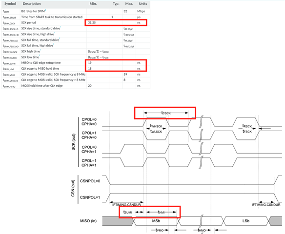

I am designing an FPGA to have a SPI slave port connected to the nRF5340 SPIM4 master running at 32 MHz.  But the setup and hold times for this configuration are missing from the nRF5340 data sheet.  The only setup and hold times are for the 8 MHz (125 nsec period) clock when using the other SPIM ports or not the dedicated high speed H0H1 ports P0.08-P0.12 for the SPIM4.
The setup and hold times for the slower ports are unworkable at 32 MHz, so I assume there have to be faster specs for the dedicated pins in high drive mode.  Per the datasheet:
  • tSPIM,SUMI  (MISO to CLK edge setup time) = 19 nsec minimum
  • tSPIM,HMI  (CLK TO MISO hold time) = 10 nsec minimum
But since a 32 MHz clock has a period of 31.25 nsec, that leaves a very very tight window of 31 - (19 + 10) =  only 2 nsec to make the signal transitions.  This is not workable.
There must be shorter setup and hold requirements for SPIM4 with the higher speed dedicated pins.  Can you tell me what the setup and hold times for MISO are?
Similarly, the MOSI timing for the high speed SPIM4 port is missing.  The "tSPIM,VMO CLK edge to MOSI valid, SCK frequency <= 8 MHz" is stated to be 59 nsec max, and it is made clear that that spec is for 8MHz and below.  But then the line below that is for > 8 MHz, but the timing information is missing - just ".." where the numbers should be.
The MOSI hold time after CLK edge is given as 10 nsec, but that may also be different for the high speed pins.
These specs are important.  We can't hook up a commercial chip, or our own FPGA design, to the SPIM4 at 32 MHz and guarantee the bus will work without these numbers.

    Have these preliminary numbers be confirmed? I can see that the datasheet has not been updated since your last post. I'm looking into this because I find the nRF52's tSPIM,HMI of 18 ns unexpectedly large when a half clock period is only 15.625 ns and nRF54 lists tSPIM,HMI as 0 ns. For the nRF52, this requires from the peripheral device a hold time after the next clk edge of at least 2.375 ns to be workable.
    I'm currently working with a device that only guarantees a hold time of 1 ns. So I cannot find a workable schedule at 32 MHz.
