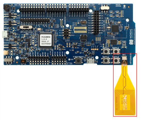

Hi, do i need to place external hardware (antenna ?) in order to be able to read the NFC info of the board?
According to the peripheral_hids_keyboad sample:

Hi Simon,
There should be an NFC antenna included in the nRF52840 DK kit that you attach to the DK:

Hi Marte, many thanks for your answer, the antenna was inside the box and I didn't see it before.
Anyway I can't read the NFC, please see the video below, I can read other devices (using NFC Tools APP) but nothing comes out from the DK,
I have tried with the antenna in both sides but nothing changes...
What can I be doing wrong?

Are you using an iPhone? BLE pairing with NFC is not supported in iOS, so the sample requires a smartphone or a tablet with Android v8.0.0 or newer.
Marte
Hi Marte, it has been solved I was doing something wrong, BTW it works with iPhone...
Thanks
