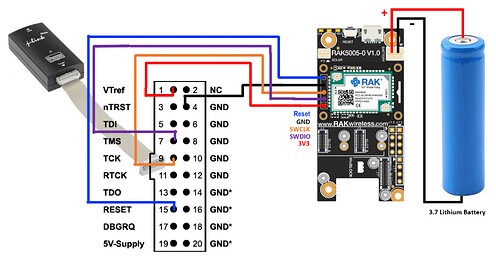

    You do not need a JLink-OB in the end product, but you need J-Link or other SWD programmers on the production line. Then you flash the device with what you need directly. The only thing you need to do on your hardware for supporting this is routing out the SWD lines so that you can hook up to it on the production line.

  • Let me explain better.  I will replace rak4631_factory_bootloade by merge file merged.hex(MCUBoot+Zephyr).
  • Let me clarify, I already tried to flash RAK4631(nRF52840) by VSCode/nRF Connect/Jlink, and nRF Connect for Desktop  v5.0.2 Programmer,  as you can see in the images below.
    In the screenshot below you can see as "connected devices":
    1. The nRF52840-DK, it is working fine
    2. The RAK4631 isn´t being reconized as a nRF52840.
    Well, below I attached the connection schema that I am using to connect the RAK4631 with the JLink, but I think that I have a problem between JLink and RAK4631, but I don´t know what.
    Maybe I will need to rewrite the MBR, but I don´t know how.
