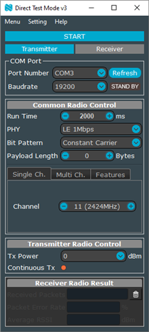

DTM in nRF5340 works only after flashing until power cycle
Hello everyone,
I have a custom board with a nRF5340 on it that is used as a BLE reader for mobile phones. Now we wanted to do some EMC testing. For this we need to broadcast at max power on a single BLE channel at a time. Well, sounds like a job for the direct_test_mode (DTM) sample. I am using SDK v2.2.0 for this, as the BLE code itself is currently based on the central_bas project from this SDK version.
A nRF52840DK is used as a sniffer in combination with the nRF Connect RSSI Viewer. This one is working perfectly fine. For initial testing I took a nRF5340DK as a DTM device, built the DTM sample without changing anything and flashed it. To control the nRF5340 with the DTM firmware I am using the Direct Test Mode v3 utility from Github. This is because on the custom board I need to communicate via UART with the nRF. Using the nRF-DTM-3.1.1 release and the following configuration produced the desired results. The nRF5340 began broadcasting on the 2424 MHz channel and the nRF52840 picked it up. So far so good.
Now I needed to get it working on my custom board. I knew from the central_bas code that usually runs on the nRF5340 that the devicetree file needed adjustments as well as some new lines in the prj.conf. The devicetree file and the prj.conf used in the central_bas project look like this:

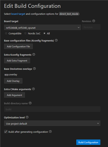

So I started adapting the prj.conf and the app.overlay of the DTM sample.
app.overlay
	chosen {
		ncs,dtm-uart = &uart0;
&uart0 {
	status = "okay";
	current-speed = <19200>;
	pinctrl-0 = <&uart0_default_overlay>;
	pinctrl-1 = <&uart0_sleep_overlay>;

The build config in VSCode looks like this:
I can see that the correct prj.conf and overlay files are used according to the build output:
