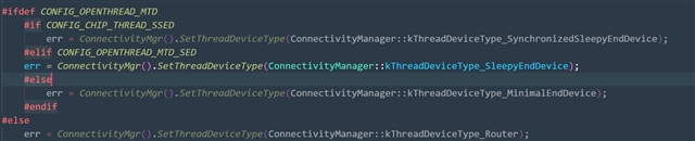

  • I already know how to modify it, which is related to the configuration of sed. In ncs2.7, I referred to the configuration provided in the sample, CONFIG_CHIP_THREAD_SSED. During the development of ncs2.5, I used CONFIG_OPENTHREAD_MTD_SED. The difference between the two is that when initializing matter, CONFIG_CHIP_THREAD_SSED sets the thread device to SSED mode, while CONFIG_OPENTHREAD_MTD_SED sets the thread device to SED mode.
    After setting to the ssed mode, the rate of sending and receiving packets is significantly slower, and it cannot be adjusted by modifying the parameters of the ICD.
    You can also try it as I said. If the effect is the same as what I described, can you tell me why it happens?
