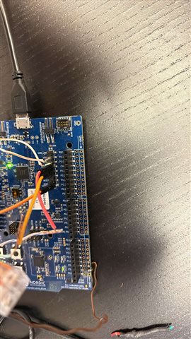

    So the custom board is powered externally, right? What voltage is the nRF running on on the custom board? What version is your nRF52 DK? What does it say on the white sticker, other than the serial number (1050385234)? And can you please take a picture of the P20 header (the one with VDD_nRF, GND detect, SWDIO and SWDCLK, and so on), and upload it here?
    Are you sure you didn't mix up the SWDIO and SWDCLK lines? It should be SWDIO DK -> SWDIO custom board and SWDCLK DK -> SWDCLK custom board.

  • Hi.
    Yes, i am sure I don't mix the SWDIO and SWDCLK. I am able to program other custom boards with a different chip (NRF52840-QFAA-F-R7).
    Im not sure what the voltage is, I am powering using the DK, and the (the standard voltage on the DK).
    Attached is a picture of the board.

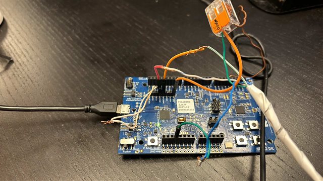

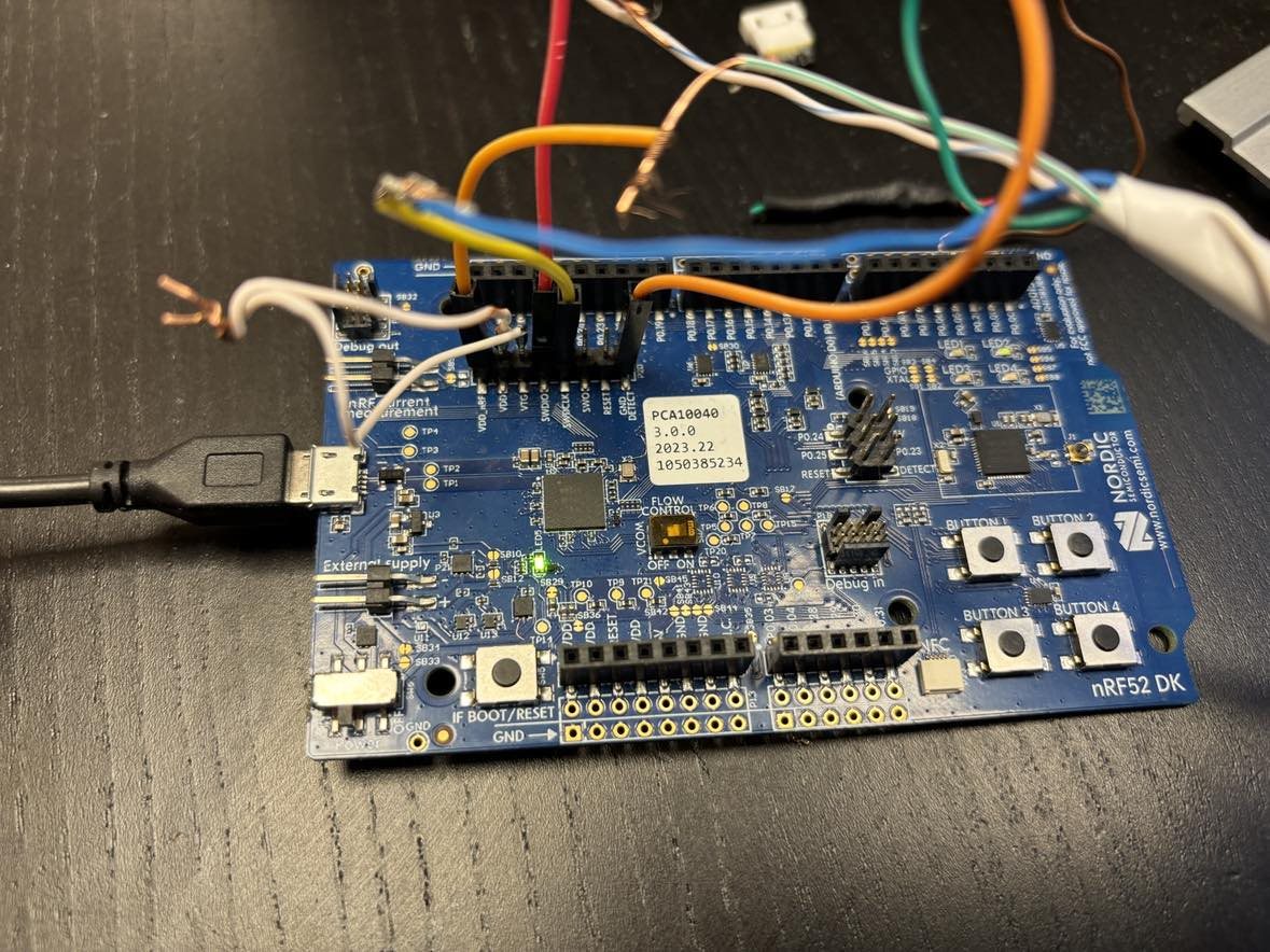

    Using this DK as the programmer?
    As shown in this picture? If so, can you please try the following:
    1: Disconnect the VDD_nRF on the far left, and plug it in VDD near the bottom of the picture. (not sure if this is needed, but it is worth a shot)
    2: Disconnect the GND DETECT and plug it in GND near the bottom of the picture.
    3: Short GND to GND DETECT.
    (4: Keep the white cable, shorting VDD to VTG)
    The reason is that GND DETECT is not actually ground. It is used to detect whether GND is GND on the connected device. So right now you are probably having a floating GND on your custom board, unless you power it externally.
    Edvin
  • Hi Edvin.
    I will try what you say. It is not easy to see from the picture, but GND and GND detect are already connected here.
    I tested connceting VDD to a different port, with no luck.
    nrfjprog --recover --log works just fine.
