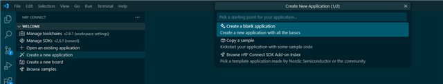

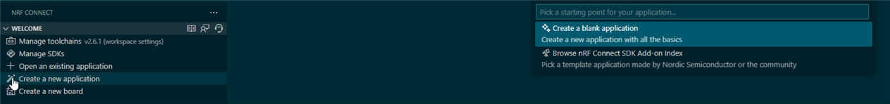

Hi Nordic community,
I'm starting this course as I'd like to start with Nordic.
I can't continue (better to say, start) the course as the instructions are different from the menu option I have.
At this point:
I don't have the option "Copy a sample". I then went to the installation folder (C:\ncs\v2.6.1\zephyr\samples\basic\blinky) and I copied to a local folder.
Unfortunately from that point onwards I couldn't continue, as the IDE doesn't allow me to execute the "Add build configuration".
How should I proceed?
