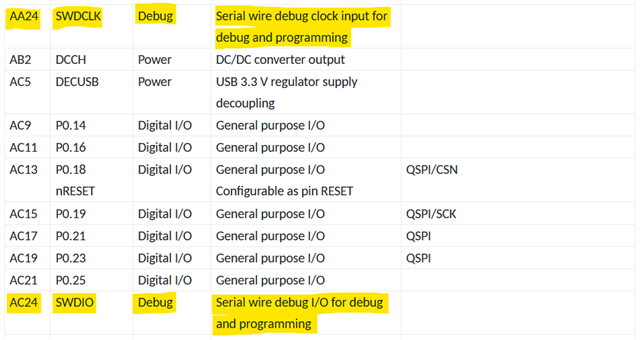

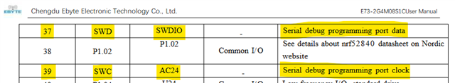

but what inputs on module E73-2G4M08S1C -
I found only:
37 SWD SWDIO
39 SWC AC24 ???
Do you have a reference for connection - so I will not burn anything?
And which one I need - connectors P19 or P20 ?
mathiaso said:GS2 said:I found only:
37 SWD SWDIO
39 SWC AC24 ???That sounds right. From the module's datasheet:
From the aQFN73 package's pin assignment list:
There you have the SWDCLK and SWDIO lines.
The following pins should be the ones for VDD, GND, and reset on your module. You'll find this in the module's datasheet, which I linked you to earlier.
Ensure that your device is powered during debugging and that the voltage on the external board matches that of the DK, as stated in the note here.
As you're creating your own board you're free to choose whether you use the 10-pin SWD connector found on P19 or if you want to connect through the P20 connector on the DK.
