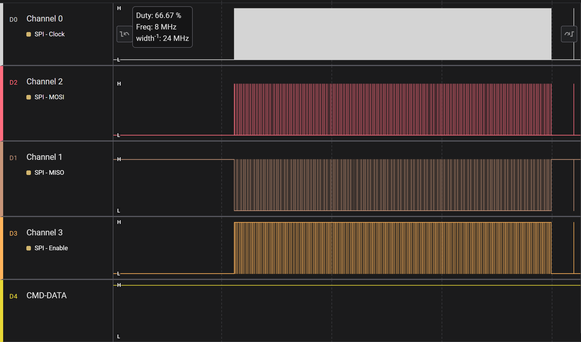

Im not sure if im getting the the right output from pin 11, 12 and 13 (clk, mosi, miso) when using a logic analyzer:
Also the D/CX and CS should be on pin 10 and 15, but not getting any change of state when putting them into the logic analyzer
cs-gpios = < &arduino_header 0x10 0x1 >, < &arduino_header 0xa 0x1 >;
cmd-data-gpios = < &arduino_header 0xf 0x1 >;

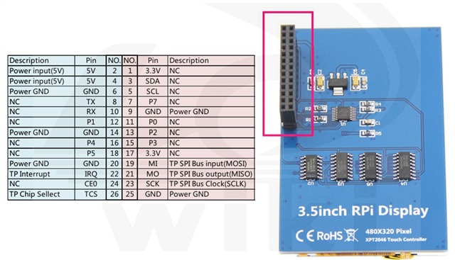

The spec of the display:
Display 3.5 inch TFT LCD Touch Screen Monitor 480 x 320 for RPi with Touch PenFeatures:● The display has a resolution of 480 x 320, which is perfectly sufficient for small projects.
Resistive touch control.
● The display is compatible with RPi A, B, A+, B+, 2B, 3B, 3B+, 4B.
● GPIO pins remain free to address other devices.
Driver provided (works directly with your own Raspbian/Ubuntu).
Supports RP-bian system, Ubuntu system, Kali Linux system.LCD type: TFT.
LCD interface: SPI (Fmax: 32 MHz)
Touch screen type: resistor.
Touchscreen controller: xpt2046.
Colours: 65536.
Driver IC: ILI9486.
Backlight: LED.
Resolution: 320 x 480 (pixels).
Backlight current: 120mA
Power dissipation: 0.13 A x 5 V.
Active area: 48.96x73.44 (mm)
Product size: 85.42 x 55.60 mm.
Package size: 118 x 72 x 34 mm.
Coarse weight (package includes): 75 (g)Box contents:

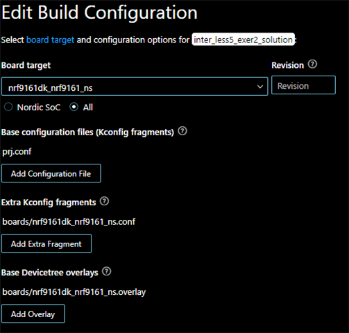

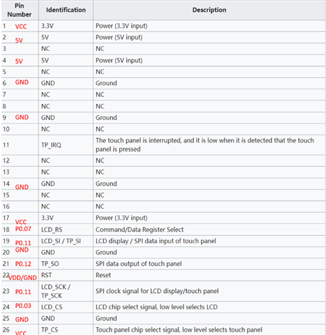

    My board configuration is this:

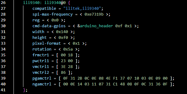

    The cmd-data pin is this one in the overlay file:
    My pinout (i tried with both default pins and custom ones (CS and cmd)):
    To answer your question: IRQ is connecting to VDD or GND, didnt know which would work, but with no luck for now.

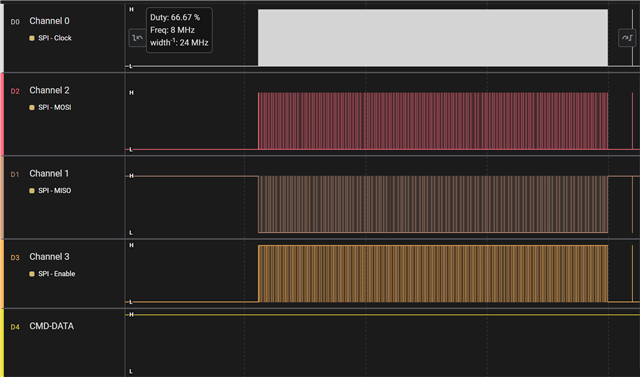

  • some screenshots of the output:

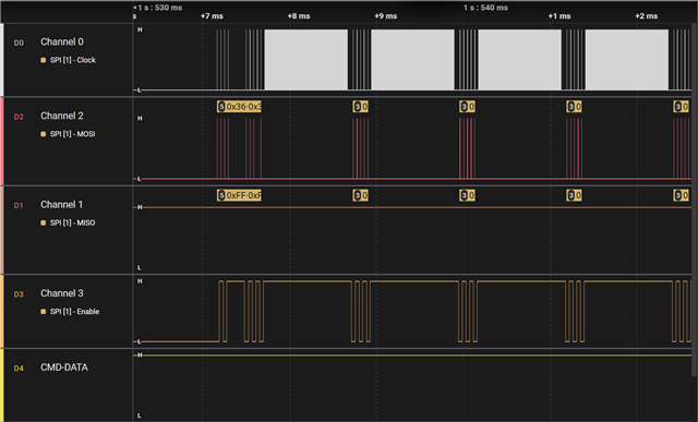

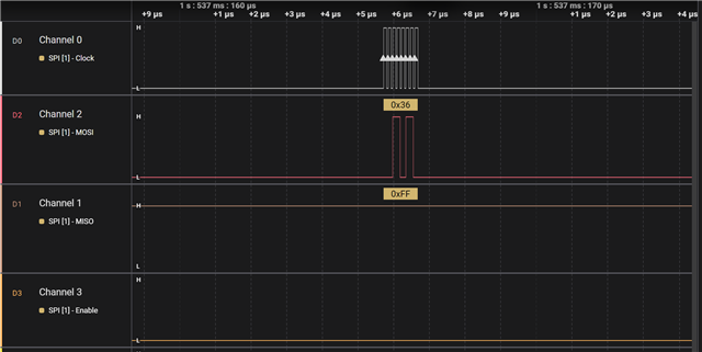

    The  first 4 hex from mosi is: 0x36, 0x28, 0x3A, 0x66
    Could you .zip the saleae logic file and share it here?
    In the picture that you attached yesterday:
    There are toggling on the MISO line, but with the resolution of the image, it is hard to say what is happening.

    There can be an issue if you use the button. Ensure that CONFIG_DK_LIBRARY=n.
    Is there any runtime logging that is printed when you run the firmware?
    Are you using ncs v2.7.0 or v2.6.2? In v2.7.0, which is based on zephyr 3.6, the way to populate a display has changed:

    The trace does not show any activity on the MISO (master in - slave out) line, which the display should use to respond to the nRF host.

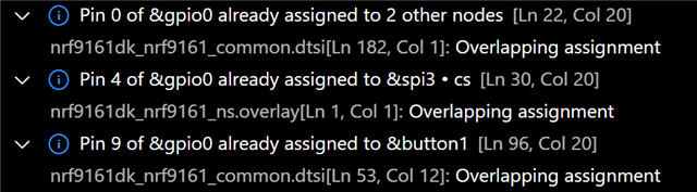

    *I put "CONFIG_DK_LIBRARY=n" into the prj.conf but it still shows the conflict between pins.
    vscode will warn you about the conflict, as the devicetree entires do indeed conflict, but if you do not use the LEDs/Buttons, the GPIOs will be unused.
    Have you checked the datasheet of your display driver to see if this is compatible with the ilitek9340?
