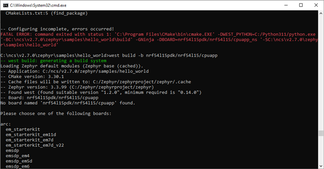

No board named 'nrf54l15pdk_nrf54l15_cpuapp' found.
I followed Getting started guide for the nRF54L15 PDK (Getting started with the nRF54L15 PDK (nordicsemi.com))  and bumped into a problem when i try to build "hello world" app.  I get the No board named 'nrf54l15pdk_nrf54l15_cpuapp' found. message.
I have started with SDK version 2.6.9, but I have also  tried also SDK v2.7.0 and get exactly the same error.  The only difference from the guide is that it is written to checkout 2.6.99-cs1 but such branch doesn't exist. SO I have tried  "v2.6.99-cs2-branch" for the SDK v 2.6.9 and v2.7-brnach for SDK v 2.7.0.

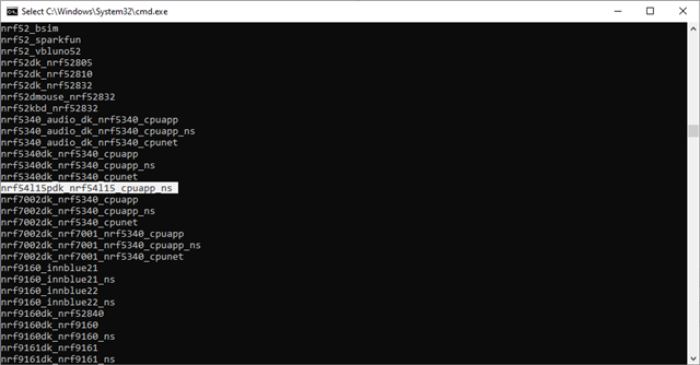

The interesting thing is that I can see the nrf54l15pdk_nrf54l15_cpuapp_ns board if I run "west boards" on the "v2.6.99-cs2-branch" branch but no "nrf54l15...." boards on v2.7-branch".

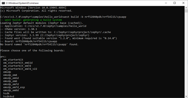

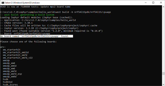

    If I check out tag v2.7.0ncs1 and then run "west update" and then "west build -b nrf54l15pdk/nrf54l15/cpuapp" from  C:\ncs\v2.7.0\zephyr\samples\hello_world I stil get the same error.
    I wonder what I am doing wrong ....

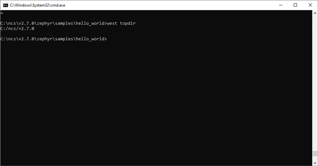

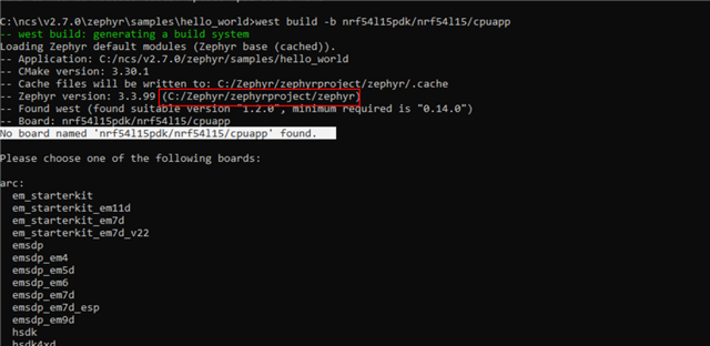

  • The tag name is "v2.7.0". The log also shows that you are building with an older version of Zephyr (v3.3.99 instead of v3.6.99), which indicates that you may be building against a different SDK.
    Can you run 'west topdir' to see where your current west workspace is located?
  • west topdir returns C:/ncs/v2.7.0 for me.
    Thanks for pointing out the zephyr version, I installed it for 6 months ago for working with another board and thought that when I checkout git brancvh or tag than  Zephyr in ncs folder is used. I guess I need to updated my installation.

  • In addition to running 'west topdir', please run
    $ west config --local -l
    to list your current workspace configuration (or post the C:/ncs/v2.7.0/.west/config file). I want to make sure it sets the zephyr base to C:/ncs/v2.7.0/zephyr and not the other zephyr repo you had in c:/zephyr/
    The reason you are not finding the "v2.7.0" tag is that you are not in the 'nrf' repo, but the 'zephyr' repo. The 'nrf' west manifest selects the "v3.6.99-ncs2" tag for Zephyr.  So the zephyr revision should become updated to "v3.6.99-ncs2" after you run
    $ west update

  • Thank you Vidar for your help, I have updated the ZEPHYR_BASE environment variable to  point to zephyr folder under ncs folder (c:\ncs\v2.7.0\zephyr\) and checke out the v2.7.0 in the  c:\ncs\v2.7.0\ncs repo and that resolved my compilation issue.
