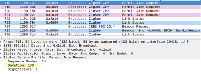

We have analyzed the Wireshark logs (attached DeviceJoined_NotInSteering).
DeviceJoined_NotInSteering.pcapng
In packet 750, the device leaves the network, but it joins, even though steering mode was not active. From our analysis, we suspect that in packet 712, the association permit was false, but it became true in packet 725, which may have caused the device to join.

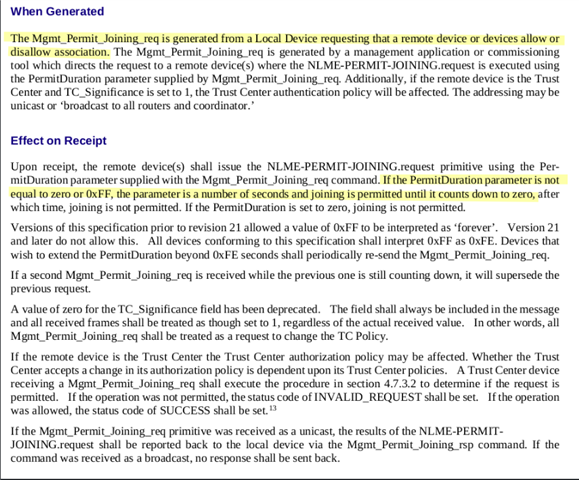

Please find my following questions:
1.Why is the association permit true when the coordinator is not in steering mode?
2.If we stop steering before 3 minutes using the stop_steering function, does it permanently stop steering, or could steering continue in the background?
Please Note: The end device is not rejoining. it is joining again as a new device.

    We would also be interested in checking the zb_bdb_close_network() result (RET_OK/RET_NO_MEMORY/RET_ERROR). The code shows that the return code is ignored. Could you check this?
    The discussion with them leads us to the following hypothesis:
    1. The "positive permission" observed by the customer seems to be an anomaly. At least that's what the protocol spec says: possible ZC reactions to AssociationRequest, BeaconRequest, .. are given, but when macAssociationPermit is "false" then in no case is a response containing permission:true allowed.
    2. According to doc/spec: zb_bdb_close_network() results in the use of a primitive for disabling permissions without a time limit. So yes, in other words the expected behavior is to close network permanently.
    Of course, let's keep in mind that:
    • we don't know if zb_bdb_close_network() is effective, because in some cases (like some buffer allocation error) it may not be
    • maybe something additional (another request?) that we don't know about yet changes the ZC device's behavior

    We had a look at the sniffer logs: 0x2a19 sends a permit join request right before the ZC opens the network, so the ZC behaves according to the specification.
    Zigbee R22 spec section 2.4.3.3.7 Mgmt_Permit_Joining_req:
    In addition the team spotted that based on the sniffer log, your device is a ZR, not a ZED. It’s possible the youæve called it an end device by mistake but knowing the correct role might be important if we need to investigate why it sends a permit join request
    Andreas
    Andreas
