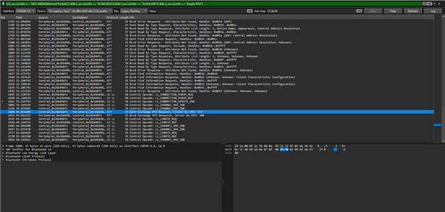

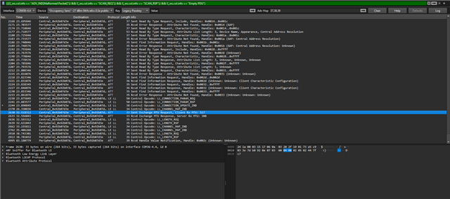

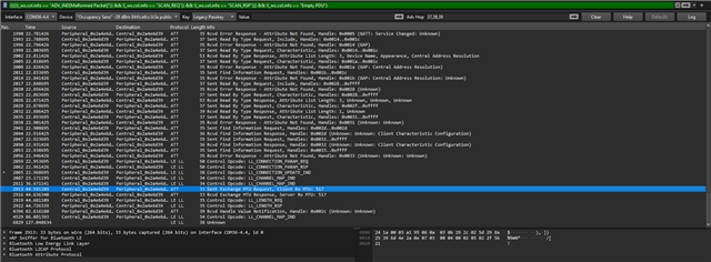

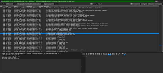

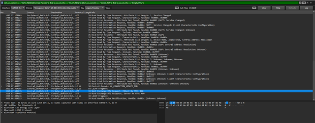

V 11:38:28.676 Requesting new MTU...
D 11:38:28.676 gatt.requestMtu(460)
W 11:38:28.774 Requested MTU not supported. MTU changed to: 517
