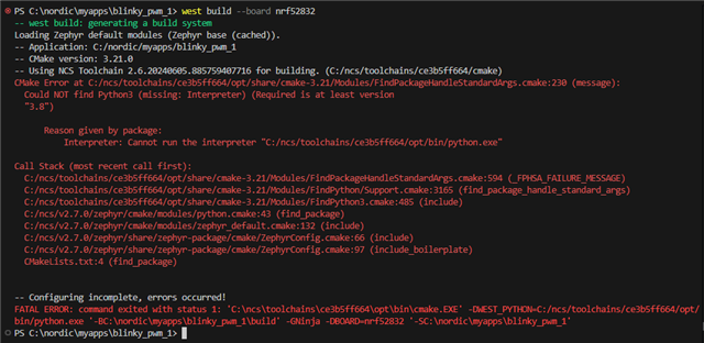

Unable to create a build configuration in VS Code using nRF Connect Extension
I followed the instructions listed in Installing the nRF Connect SDK (nordicsemi.com). Then I followed the steps in How to create and build an application (nordicsemi.com) but I keep getting the error shown in the attachment when trying to build the application. I am stuck at the 'Add Build Configuration' step with the error attached. ("Could NOT find Python3"). Could someone please help me figure out what I am missing?
When I hit 'Build Configuration' the nRFConnect Terminal just sits there spinning with no output or error. Then, I tried to use 'west build' command and that's when I see the error attached.
Using toolchain v2.7.0
SDK v2.7.0
    Looks to me that something has gone wrong in the installation procedure.
    Could you follow the installation steps in https://docs.nordicsemi.com/bundle/ncs-latest/page/nrf/installation/install_ncs.html and select "nRF Connect for Visual Studio Code" for every step throughout the way? You should not be required to use chokolatey for anything.
    The same steps are explained in https://academy.nordicsemi.com/courses/nrf-connect-sdk-fundamentals/lessons/lesson-1-nrf-connect-sdk-introduction/
    Can you also copy-paste the full build logs instead of pasting screenshots? Attatch them using Insert -> Code or as a .txt file.
    Andreas
  • Hello Andreas,
    I followed the steps on the link you provided(which is what I have done quite a few times before I decided to ask for help on the forum). I installed the 2.7.0 toolchain and the 2.7.0 SDK. When I try to add a build configuration and start a build, the task seems to be "hanging" (spinning wheel and grayed out configuration tab). There is an error on the 'Output' tab reported right away. "Error: there is no registered task type 'nrf-connect-generate'. Did you miss installing an extension that provides a corresponding task provider?"
    To try another way to generate a build output file, I tried to use the command on ther terminal
    > west build --board nrf52832 (possibly incorrect but I have a build folder and a file in there that I have attached)

    I am working remotely and wonder if the antivirus software installed by my company could be preventing any script from running? The reason I used chocolatey was to try another installation method - Installing manually (nordicsemi.com). I ran into an error from Cyclance preventing the scripts from running completely so I abandoned that route.
    Any help or guidance you can provide would be greatly appreciated.

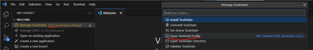

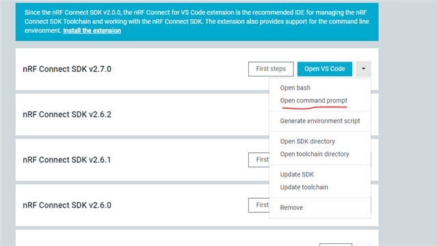

    1. Could you open a command pallette and generate support information? ctrl+shift+p >generate support information
    2. So the general approach I would recommend is that you start completely from scratch, i.e uninstall all the tools (nrfutil, nrf-command-line tools, Segger, vs code extensions, any appdata) and follow the procedure once more. These are errors that typically come when something has gone wrong in the steps. And yes, I know you've reinstalled it many times, and so have I in the past when I've seen these kinds of errors.
    3. Alternatively if you have another windows machine available you can see if you're able to reinstall
    4. Could you verify which version of Windows you're using? I'm assuming W10 or W11
    5. Is this the exact build command? "west build --board nrf52832" should not return the build log you're seeing unless you've set up custom aliases. It should return the following
    (v2.6.2) C:\ncs\sdk\zephyr\samples\hello_world> west build --board nrf52832
    -- Application: C:/ncs/sdk/zephyr/samples/hello_world
    -- CMake version: 3.21.0
    -- Using NCS Toolchain 2.6.20240605.885759407716 for building. (C:/ncs/toolchains/ce3b5ff664/cmake)
    -- Found Python3: C:/ncs/toolchains/ce3b5ff664/opt/bin/python.exe (found suitable version "3.9.13", minimum required is "3.8") found components: Interpreter
    -- Cache files will be written to: C:/ncs/sdk/zephyr/.cache
    -- Zephyr version: 3.5.99 (C:/ncs/sdk/zephyr)
    -- Board: nrf52832
    No board named 'nrf52832' found.

    2. I will give this another try.
    3. I don't have access to another machine. I would have to ask one of my colleagues to try this out which is currently not an option.
    4. Windows 10.
    5. The file I attached earlier is the CMakeCache.txt file found in the build folder, not exactly the build log. Maybe that's why it looks different. I apologize for attaching another screenshot but I don't know where this build log is located. This is what I see when I run the 'west build' command.
    Lekha
  • Thank you for verifying
    A quick thought: Is this command entered in a generic cmd or one opened through the toolchain? I.e
    (Ignore the mismatched toolchain and SDK on my part, I have multiple instances opened at the moment). If it is a generic terminal and not a "Terminal Profile", could you try again by opening the Terminal profile?
    And if you do see the same issue that I saw when building with "west build --board nrf52832dk", could you try again with the correct target, i.e "west build --board nrf52dk_nrf5232". I assume it is a nRF52DK you're using (which has the nRF52832 SoC onboard)?
    Andreas
  • I opened the terminal from the toolchain and tried the command again with the same build errors as before. I also tried with the correct target with the same error - "Could NOT find Python3". I think reinstallation is the way to go.
  • Thank you for confirming, keep me posted about the progress
    Andreas
  • No luck.

    Two more suggestions:
    1. Open a terminal profile from VS Code and enter "where python" and "python --version".
    2. Another angle of attack is to attempt the installation process through the toolchain manager that you find in nRF Connect for Desktop: https://www.nordicsemi.com/Products/Development-tools/nRF-Connect-for-Desktop
      Installation procedure should be similar to what you've done.
      Then after installing SDK and Toolchain, open the "Toolchain Manager in nRF Connect for Desktop", click the arrow next to "Open VS Code", and "Open command prompt" to open a terminal with that toolchain profile.
      Then repeat the steps with "where python" and "python --version"
    Andreas
