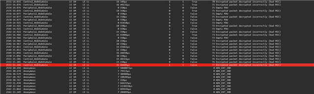

    Yes, you should be able to see the pairing exchange before the link is encrypted. You will also be able to decrypt the packets if the peripheral only supports legacy pairing.

    Thanks for the update. I'm afraid I don't have an explanation for why you're not seeing the connect request when using the other app. The central must always send a CONNECT_IND PDU to the advertiser to establish the connection. The RPA is typically updated every 15 minutes and is only used in the advertising state. The CONNECT_IND PDU contains the necessary information for the sniffer to follow the connection, regardless of whether an RPA is used.

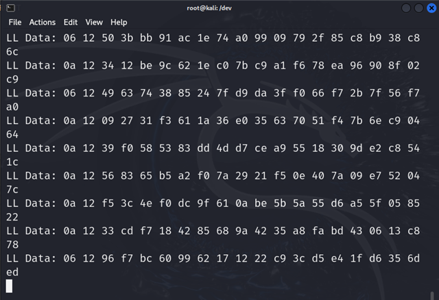

  • me too,i use the micro:bit chip with btlejack(with nrf52832) to check if my device is "unsniffable",but i find that btlejack tools can normally sniff the following encrypted packets,while my wireshark (with nrf528400 dongle) only have receive several packets ahead and stops.
  • The sniffer will lose track of the connection as soon as an encrypted channel map or connection parameter update is exchanged.
