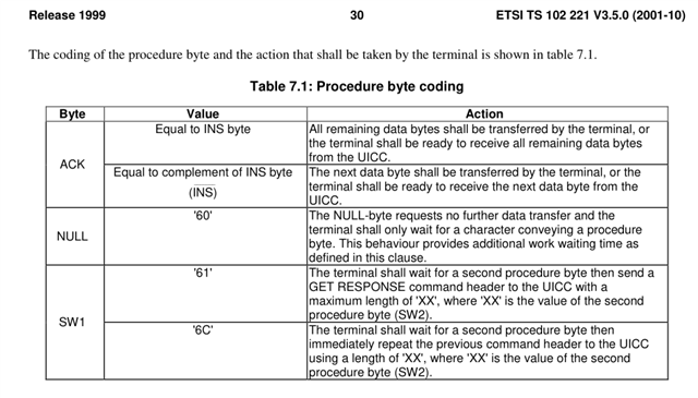

Is there a way to tell softsim to wait more than 2s?
I'm evaluating the nRF9160-DK with the SOFTSIM feature enabled.
I would like to know if there is a way to tell the softsim to wait for APDU response for more than 2s?
My board details:
*** Booting nRF Connect SDK v3.5.99-ncs1-1 ***
nRF lib version: v2.6.1
