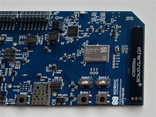

I have the nRF Hw v2, and it seems like I did something wrong with a Fw:
nRF is recognizable by a computer as the COM10/11/12 device:

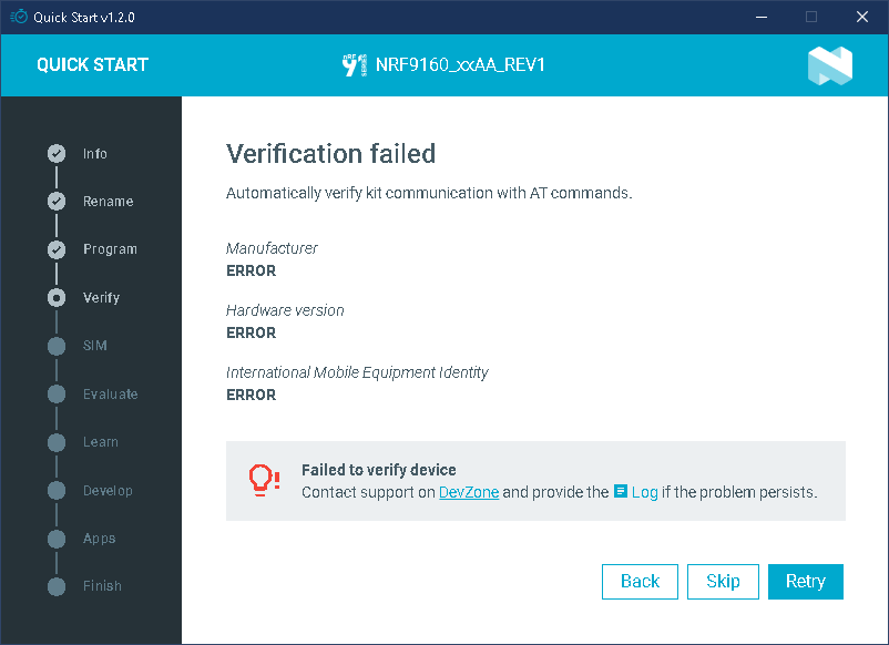

Most of the nRF Connect Desktop applications could recognize the device, but, unfortunately, they can not connect to it, and return an error:
or return nothing:

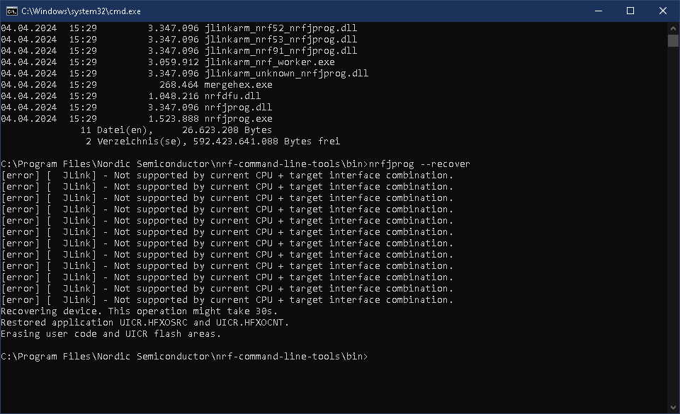

t looks like the Fw Application is loaded on the nRF and it is booted properly, while the modem does not respond.
Is there any Fw for the modem?
I saw some Segger software tool, and it offers to restore some image from time to time. Could it be connected to this problem?
